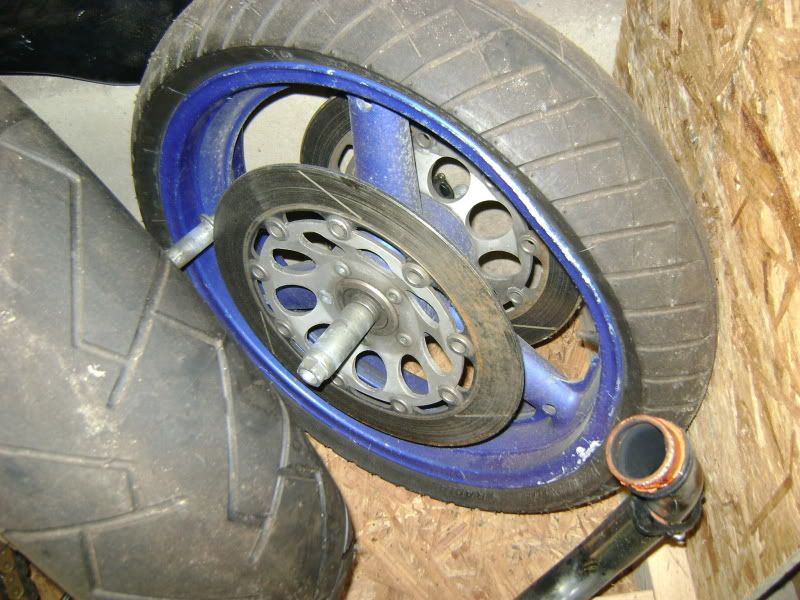

I have 2 different bent front wheels :( The one that has the concave hats on the brake rotors is off the 92 (I prefer one of these so I can use the speedo drive), anyone know what the other wheel is off of?

Forks look like early SRAD in stock 1100 tripples. The Rotors are deffinatly SRAD/TL.
