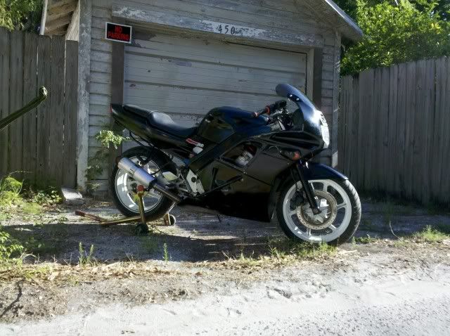

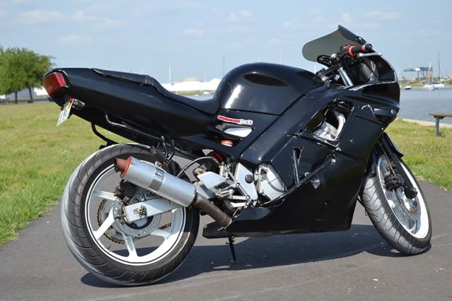

My bike when I first bought it. Too much plastic junk. Excluding the crap body work, the bike was sweet. Frame good, no rust, motor felt brand new, I couldn't ask for a better start.

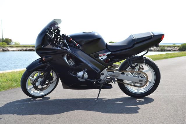

Took it for a full fairing ride in between commutes back and forth to work.
Then today, I had time to get into it. I'm building my bike in phases. Decided it's what will work best for me. I ride my bike daily for transportation. My first phase is a rat / trial phase for a fighter.

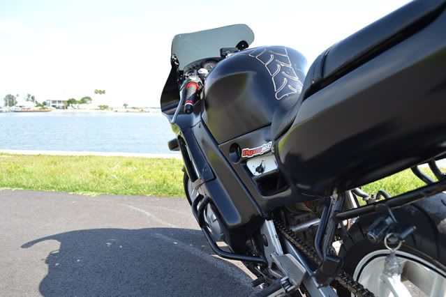

Picked up a can of VHT super high temp paint for the exhaust. Got rid of the years of paint, abuse, weather, and road grime. (see previous posts above for condition of headers) I smoothed the header pipes out to an almost polished level, then painted them. Piss poor prep produces piss poor paint, right? I think I got tennis elbow after doing all the sanding, but it was worth it in the end. Also smoothed out some previous fiberglass repairs from the previous owner and quickly painted the belly pan. Sanded down some rash sections on the muffler too, prepped and painted it, along with the worn out red end cap. Pictures from the cell phone, will get better ones when I go for another ride.
