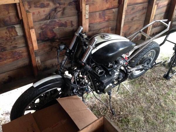

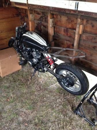

Pictures of how the bike looks currently
List of things I need to do:
Install intake cam and time the engine and break it in
Redo the tail and buy a seat
Increase rear spring rate
Buy/build new rear sets with shift and brake linkage
New tank mounts
Headlight/ taillight/ turn signals edit: found my taillight and rear turn signal setup, now I just need to find a fitting headligh
Get a battery (realy want an 8 cell antigravity but I'm not sure if I can bring myself to spend that much)
Cut up the headers and build an exhaust that does not suck
Its a soild start to making a cool bike from something that was not awesome but it has a ways to go before being rideable. Hoping to have it on the road in the next month so I have most of the summer to ride
