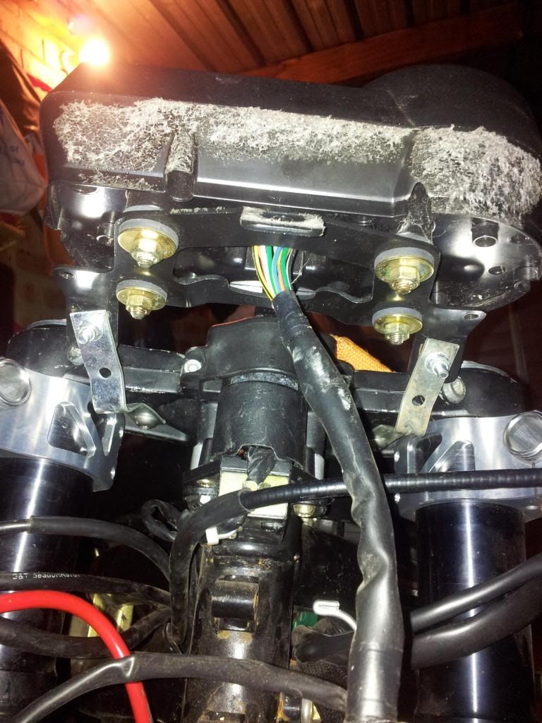

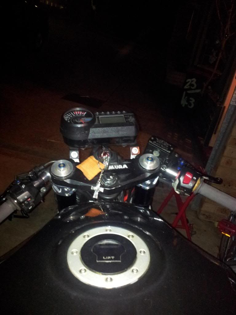

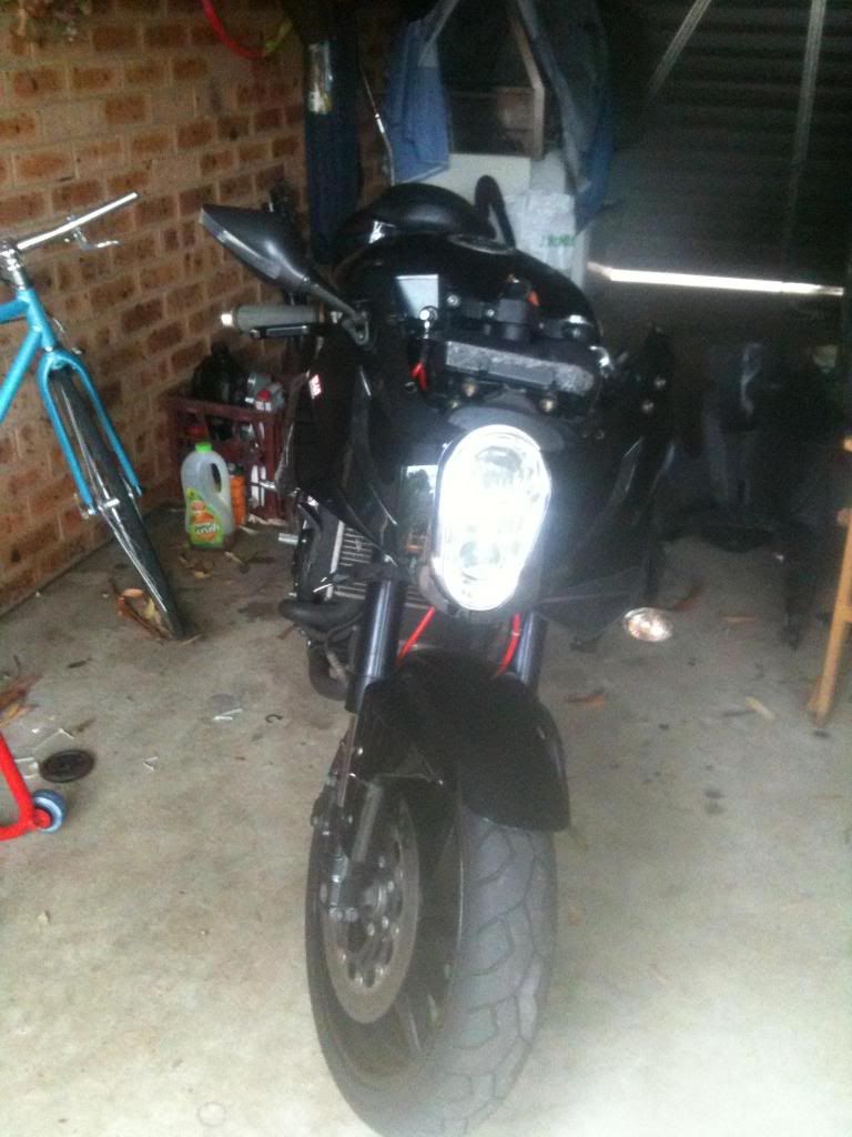

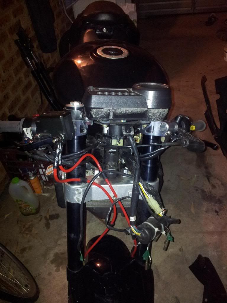

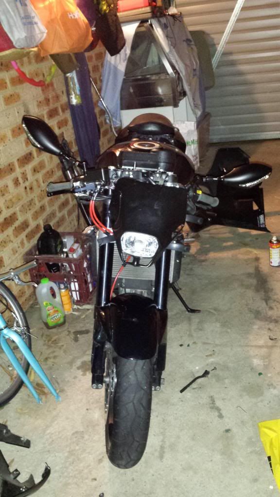

Hey guys i have a Hyosung GT650 R 2012. I had a pretty bad crash last year, and broke my ankle. Since then i haven't replaced the fairings( the bits and bobs that broke ), so i decide to switch it to a street fighter. Their is plenty of work to do but for now this is it...
Before....
Temp bracket holds...
Weight savings up to 6kg-7kg
After---
It's not full strapped on because the bike wasn't kicking over, and i thought i may have not made proper connections..
All the lights and indicators come on but it won't start:fish4rep::fish4rep:
Variables---
* Headlight configuration ( as in where i've put the high and low beam.. but i've since switched them around and it still wont kick over.)
*Has two bulbs, but i only know that one has 35 W. The original bulbs were 55w
*The integrated LED indicators when turned on, rapidly flash...
Everything works when the bike is on but not starting... Ive read on other post on here that i may need an LED relay or resistor...:gdogg::CK187::mad::wtf::wtf:
