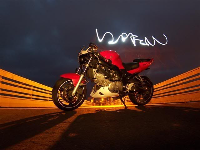

I've read every thread about plastic modification, but i'd like to hear what you may think about my options. keep in mind my experience with body modification is zero.
my bike:
I want to cut my subframe a bit, really just do a bit of trimming. what i'd like to do is cut my tail piece to make it slightly shorter and angled so it's taller. so how i should rejoin the plastics is question number one. Should buy a plastic welder? should i use epoxy and fiberglass? what's the easiest? what will create the best hold?
question number two: after the tail is formed, i would then have to put a "top" on to fill in the void created by the missing rear seat. i don't need it to open and close. i just need the "hole" covered. how would you go about filling the void? create a mold with foam?
