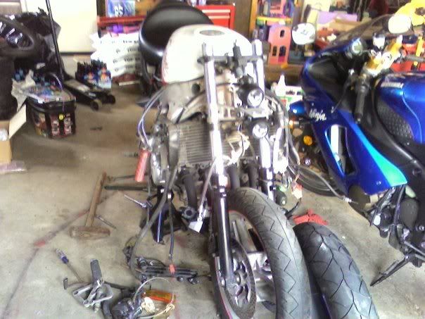

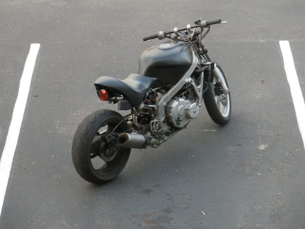

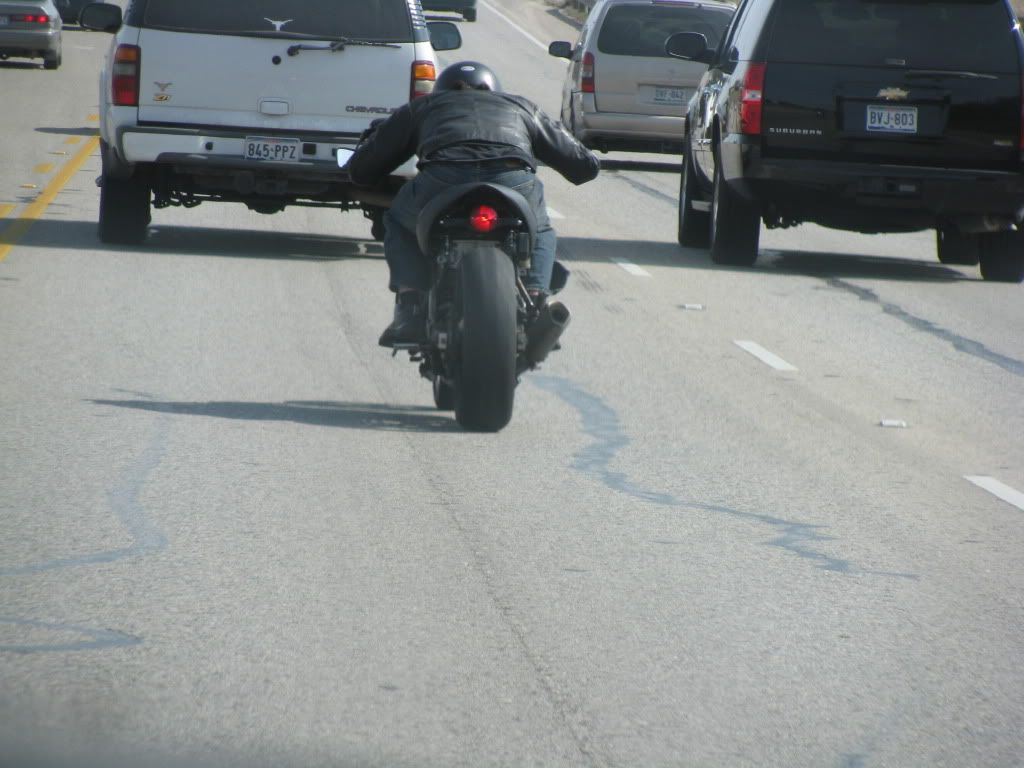

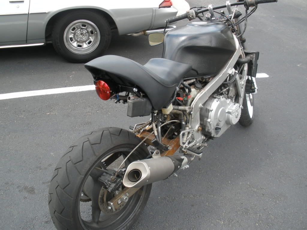

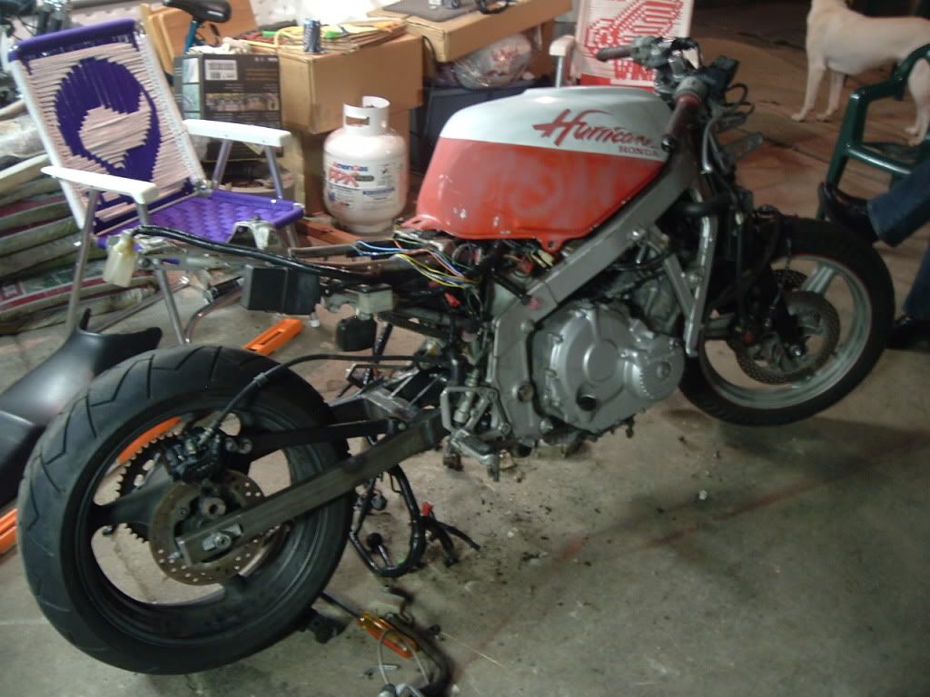

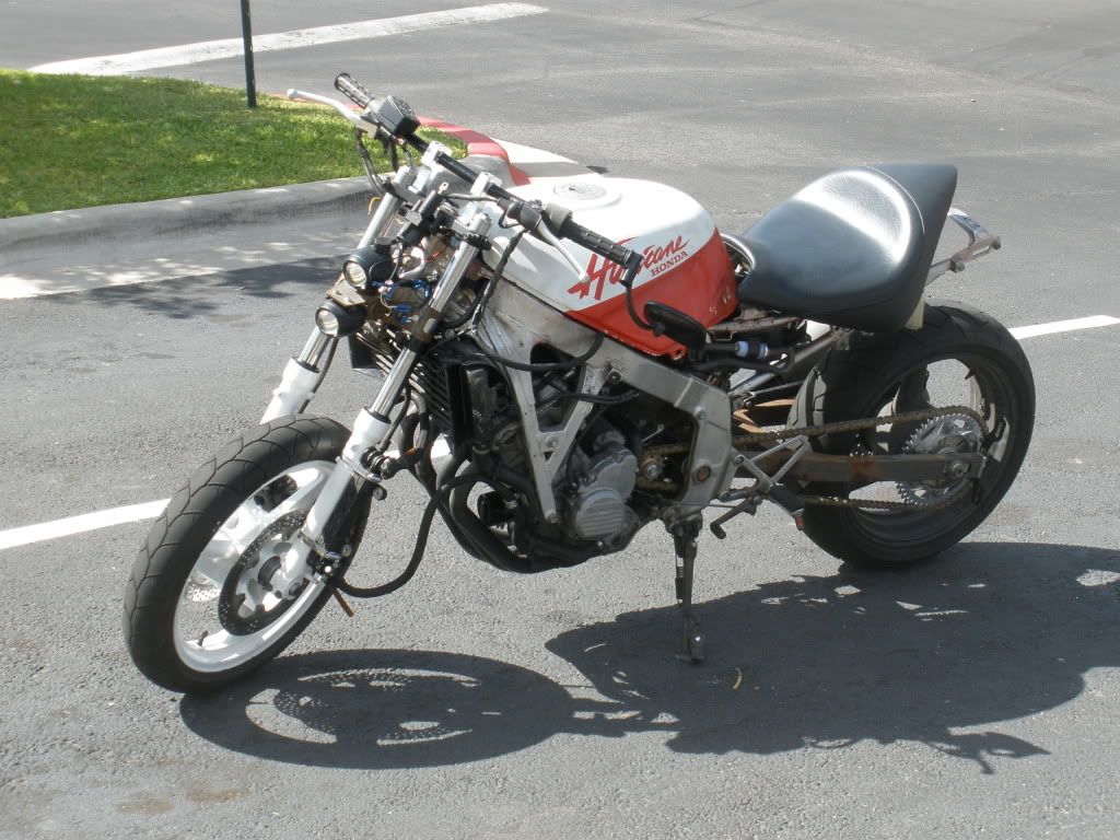

Hey, my name is Chad, I'm 33, I live in Austin, Texas and I stumbled across this website and thought I'd join up. I bought a bike from a friend in MI 5 or 6 years ago now for $500 bucks, and began tearing apart to see what I came up with. I had never heard the term "street fighter" then, and it wasn't until people called the bike by that name that I began to see and find others done in the "style", if you will. Here are 23 pics chronicling her development. The bike is currently comprised of 4 different bikes. The original bike chassis and engine is an 87 or 88 CBR F1 Hurricane. The seat is from a 2000-something Honda VTX 1800, the can is from a 2000-something Yamaha R6 I think, the rear tire is from a Honda CBR F4i, and the risers were from a Harley of some sort but now they are from some other Honda cruiser. The tail light is a 4-function trailer light from Advance Auto Parts, lol. I built several of the components that allow the swingarm (approx. 1 foot longer than stock) to work. I shimmed the front sprocket for proper chain angle, I dropped a tooth up front and gained two in the back. I measured, cadded, then made the rear axle compression washers, and modified the original chain tensioners. I also fabbed a headlight bracket, and lots of other stuff. I went upstairs to solve what turned out to be a simple math problem using basic trig identities, went back downstairs, located the new hole I wanted, drilled them, and lowered her 4" in the rear. She is 100% street-legal, pending the license plate being re-mounted on the side. I rode the CRAP out of this bike for a whole year before switching back to my VMax, Lilith. Riding Scylla is like surfing on pavement. I consider this bike about half done for now. Still in the works are rhino-lining the rest of her, custom chip-controlled white led lighting that flashes every time cylinder one fires, oval headlamps (HIDs if possible), and new triple-tree modifications that will allow a 180mm wide tire up front. I am also pondering a belly pan and a few other air deflecting foils. Time and money will tell.
