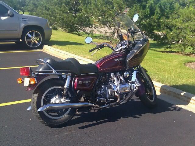

I picked up a 1982 GL1100 Standard a couple weeks ago for $1,300. It's the naked version, but it came with a Vetter fairing and a god-awful ugly sissy bar. The bike runs and rides great, but needs some minor cosmetic help plus some maintenance. It has ~58,000 miles, so it's definitely due for some attention. This is my only bike and since I have been bikeless for almost 2 years I am going to ride the hell out of it and work on it as I go. This will not be a full strip and rebuild, this is going to be an extremely slow project. Initially its just going to be catching up on maintenance and stripping the uglier bits off. Hopefully I'll be able to strip her down this winter and do some real work. For now, I'm just happy to be back on 2 wheels.
As I picked it up
As it sits now
