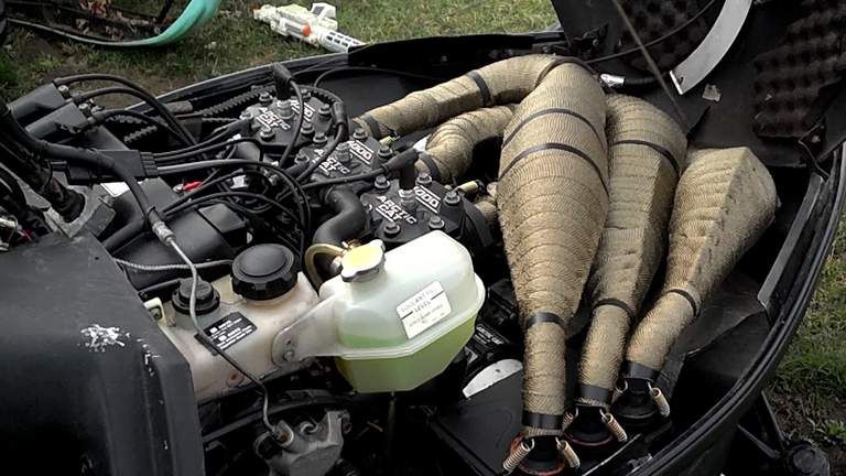

Btw i rock header wrap all winter on my big triple arctic cat. And i have very nice pipes under the wrap. Cause they are cared for and treated with respect.
My pipes constantly eat snow and get wet. But they DONOT stay wet long. Its pretty awsome actually.

Out of all that... the 1 thing that rings out to me is the length of time it takes to cool a wrapped pipe. And perhaps some.of my positive experience with this is because they live in 20 and below degrees. Speeding up the cool down to be as good as a.bare header cooling on a summer day. Or just a bit faster.
Can we also take into account material quality. We all know 90% of mildsteel headers for car applications are pure shit. And prolly half or more of the aftermarket stainless is shit too.
I do concede that ive heard many a horror story about "wraprot" ... and pipes on my sled ARE shit mild steel. But in nice condition. :) ..so with all that in mind i make damn sure to treat those babies with kid gloves. And so far its done me well. I keep higher pipe temps which allows me to clutch a few hundred rpm higher.. and on a sled that means more mph as a result.. the other benefit is the incoming air isnt cooling one pipe or another throwing the tune up off.
I will say when.i spend good money on bitchin pipes theres only one consideration. Swain tech. Then a wrap job to mask the pipe.brand and the heavy $ spent at ST. :).
And ty steve... i appreciate that.. it took awhile to get compound curved cones wrapped with any kind niceness.

On a side note, I notice your headers go up above your engine, rather than down around it like a motorcycle's. Thus, when you change your oil and filter there is slim chance of it leaking all over the cloth header wraps. On the other hand, it's very easy for a motorcycle to dump oil on a header during an oil change; so how do you wipe oil out of cloth as opposed to wiping it off bare metal? Unless you think it's a good idea to change your oil with cherry red pipes (of course, wouldn't the bike have to be running to keep bare metal cherry red)? Sure, it's great to sound cavalier about a fire erupting between your legs, especially when it's something you don't have to worry about.
No oilchanges. Shes oil injected. And who on earth would change oil around hot pipes.. really? Theres only 1 time when oil would meet a hot headpipe. Thats a mech failure..... who doesnt fashion a bitchin aluminum foil oil drainoff doohickey to keep them from having to even worry about wiping a pipe down..
