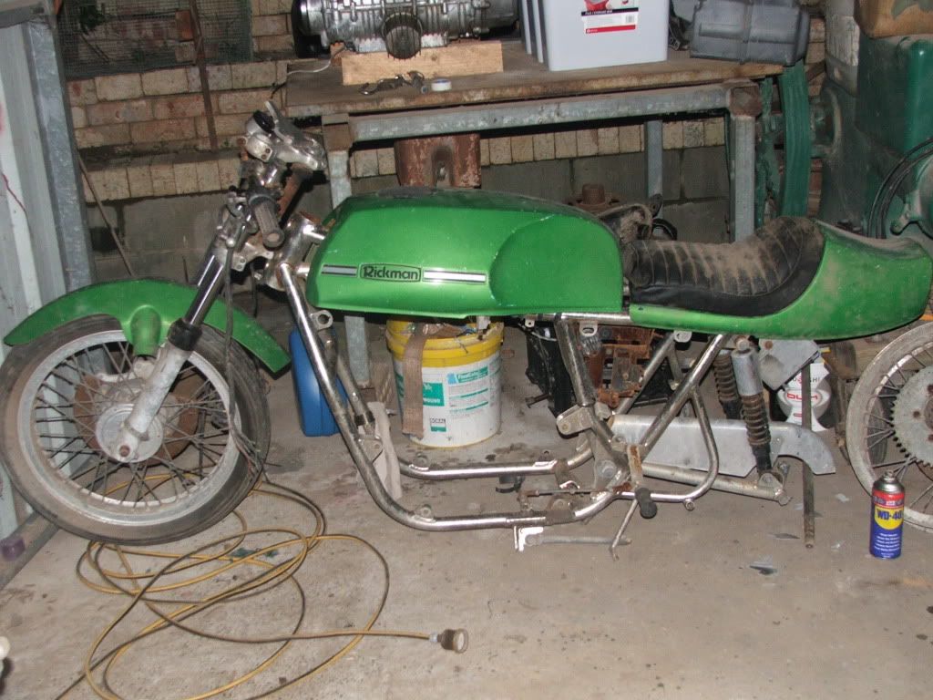

So my dad had a Rickman rolling chassis in pieces all around his shed. He told me if i wanted it, i could have it. so i jumped on it and went out and got the engine and all the other bits and pieces. Its nearly all there apart from a few small things.
I know that technically this isnt a fighter or a custom, but i can imagine some of you will be interested in seeing it.
Plans from here
- get all the left over pieces (tail lights, bolts. nothing important)
- get the frame repaired and re plated (the right way, i wont be doing this half assed)
- wheels respoked and polished up
- a few other things...
what are your opinions on rickmans? hope you guys enjoy the thread

this bike is sex on wheels
Reactions: -Rik-
15,065 Posts
Thats a hell of a start to an awesome bike.
fighter transplant in NC
14,319 Posts
This would make an amazing period correct repliracer. It would be awesome!
