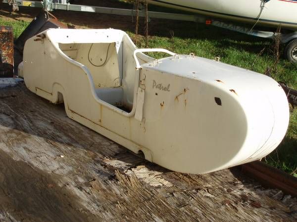

here is my project
I have a 86 honda goldwing that i got for free- title and such
i was just going to polish it up and sell it but i found a sidecar body cheap and i got a crazy idea.
i know this is custom fighters so goldwings and sidecars dont mix with fighters but you guys are super resource full so i figured i would post it here.
I referee roller derby and since it is a small but exploding sport i end up driving long distances to get to games. i hate cars so i would rather take a bike but there is alot of crap to carry esp if my wife is playing in the game. so i want a bike that can haul all of our crap and serve as an ambulace to take her home after she breaks herself.
About a year ago i stumbled across a leaning sidecar arrangement where the bike leans independent of the hack this is the arrangement i am going for with this build.
so here are a few blury pics as right now i have just stripped a couple hundred pounds of plastic off the bike and extra metal. last pic is of the tub i picked up for 300 bucks
I hope the pics work i'm new at this forum thing.
