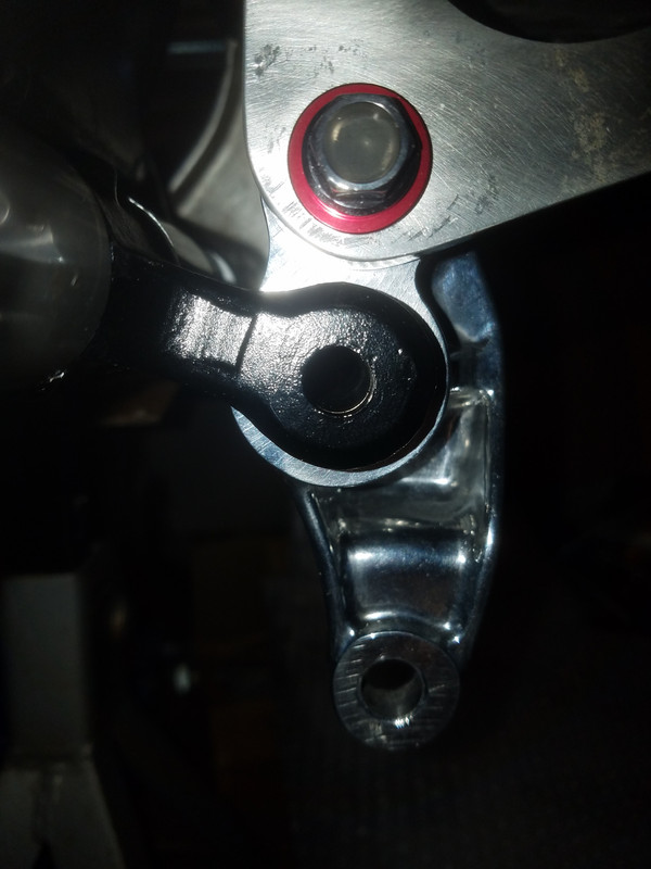

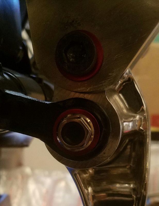

Seb decided to make the link brackets stronger by adding some material. Couldn't install the arm, though. Linkage brackets hit the dogbones.
Made a couple of steel templates. Here, the templates are on the R6 arm:
Clearance with the R6 arm:

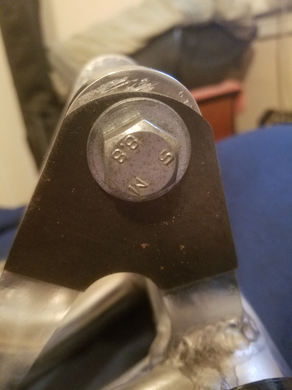

Here, the templates are on the custom arm. Shows how much material I chopped off. May still chop more:

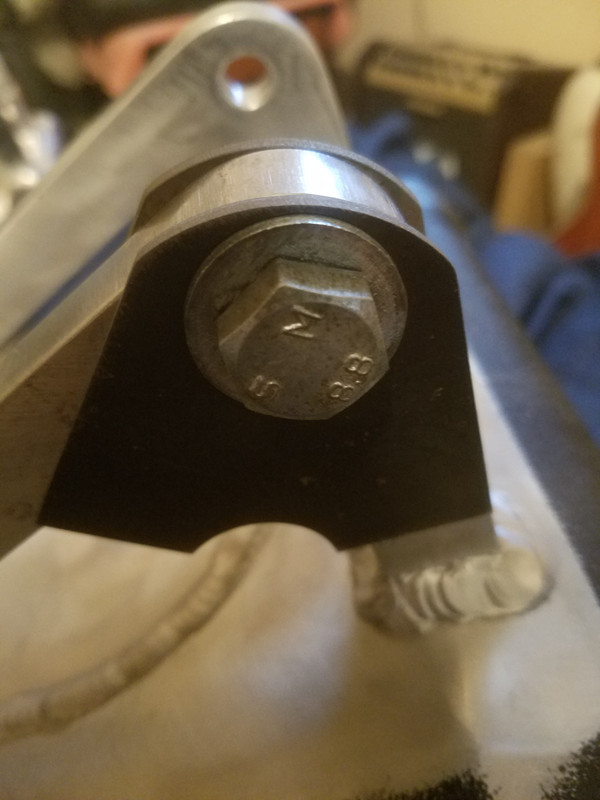

Did a quick chop with an angle grinder and hand file. Still need to clean it up & polish:
Need to recheck when I modify for more rear wheel travel. Not the best pic, but you can see some clearance on the custom arm brackets:
