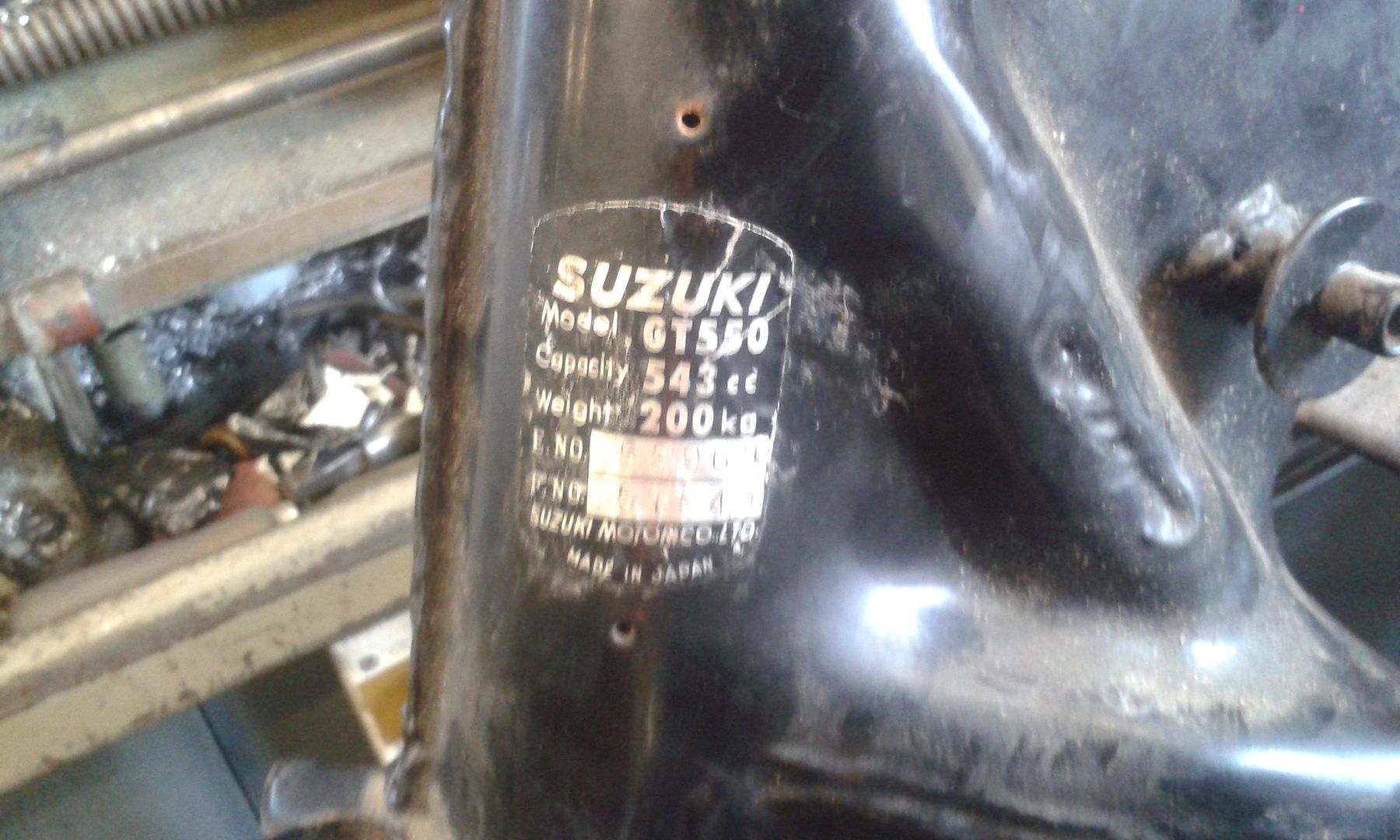

it's a GT550...... heavy lump of jap iron

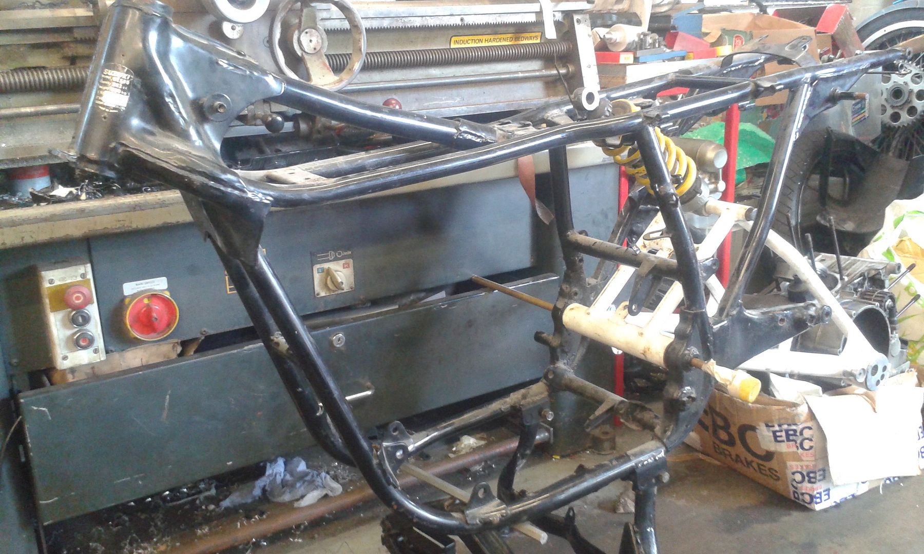

throw the original arm in to get the angle of the dangle
and then pop the Harris arm back in
so far so good, best get to it
10,855 Posts

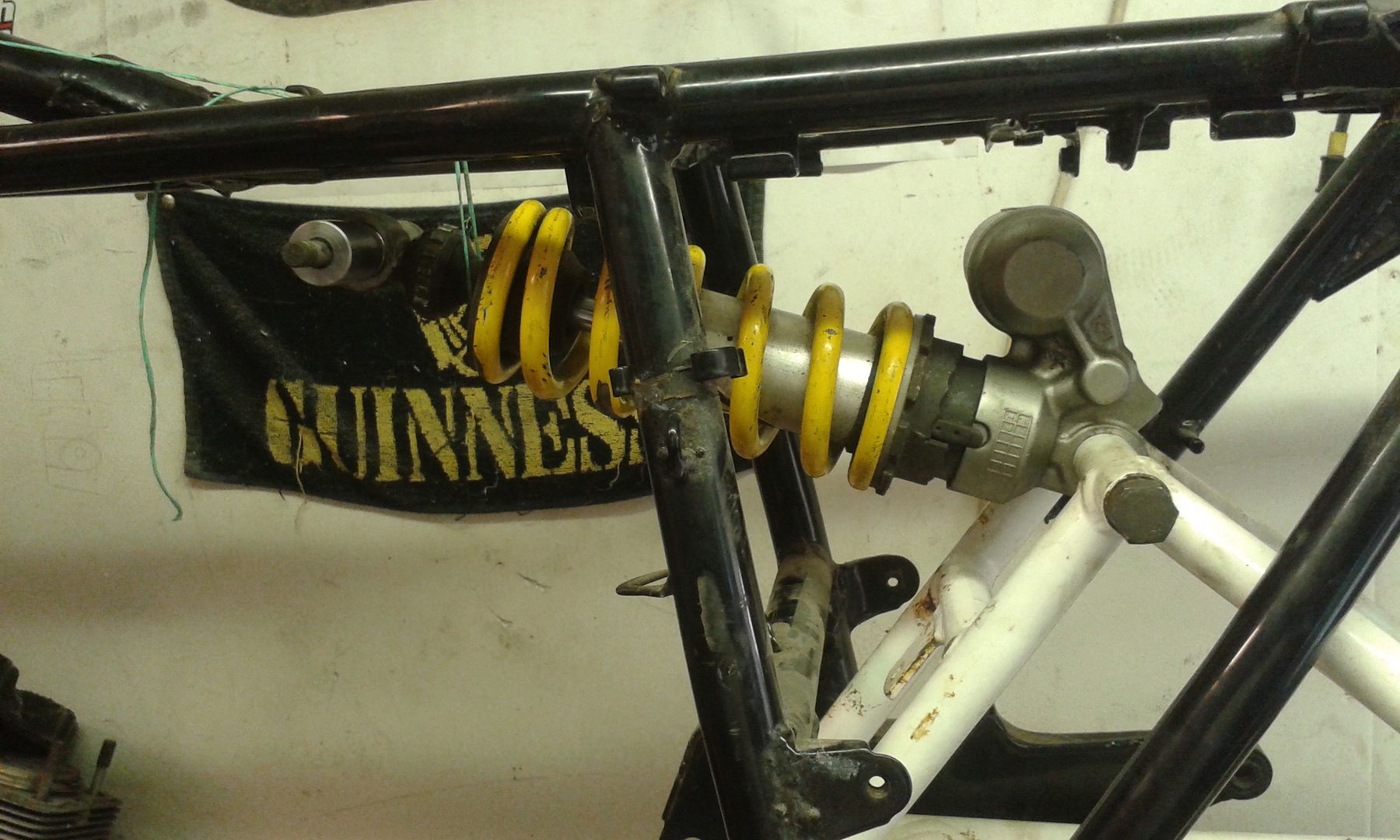

by tomorrow i want the arm to sit like this without the need for straps and string
this cross piece wasn't going to cut the mustard
so off it went and a new tube moved into the vacant spot
these will form the new top shock mount

top shock mount is buttoned up
frame looks a bit less cluttered now
now to sort the subframe
