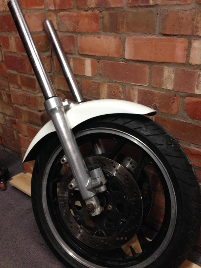

I have been making up some spaces for the front wheel, I was trying to slim down a speedo drive to fit in so I could use the original clocks but the zx12 forks were never designed for a speedo drive and I was unable to make it small enough by a couple of mm. I will have to go down the magnetic sensor route so I am considering the Koso dash.
First wheel spacer, I will have to make another one now
The speedo drive before I trimmed it down, I got the inner length spacer correct but there wasn't enough room for the drive to fit between the brake disc bolts and the fork leg. I took it as thin as I could but the drive gear broke through and I still need a few more mm clearance.
John

So after making up the front wheel spacers I found out that the wheel is offset and the spacers need to be different sizes and also thinner Back to the lathe then!
New spacer on the right.
New scrap lump of ally for the larger spacer with the axle through it just checking for size.
And all the bits ready to put in the bike.
