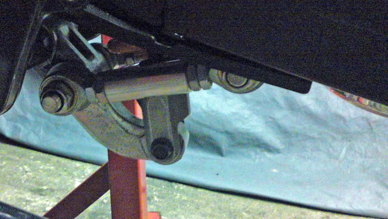

im going to use the gixxer shock as it was reworked with tech 2000 internals and has a harder spring
so currently got a reducer made for the swingarm pivot when we fitted it all together relised the top shock mount had to be ground off
and a new ones being made to ensure the shock clears the arm
got a set of dogones and hacked them to see what the rideheight is like from that scott is making me up a set of adjustables so we can get the ride height down a bit

scott fabricated up the top shock mount worked a treat shock now clears the arm and the adjustable dog bones he made for me let me drop the bike down not that you would notice it much with the seat unit on
