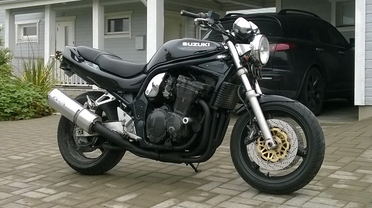

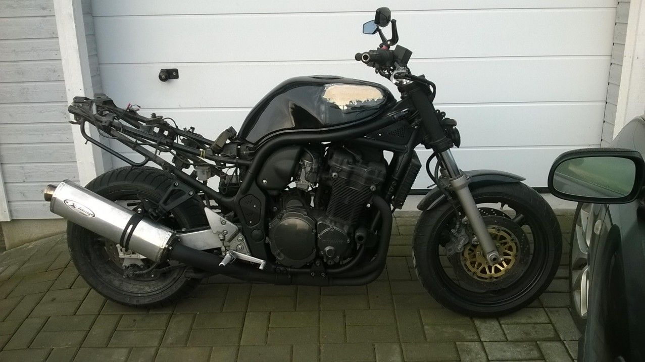

Bought a 1997 Suzuki Bandit aprox. a month ago and Im not very patient to wait starting a project that is already finished to the very last detail in my head.
Before that I went through thousands of projects to get the best lines into my bike and thats what it looks now.

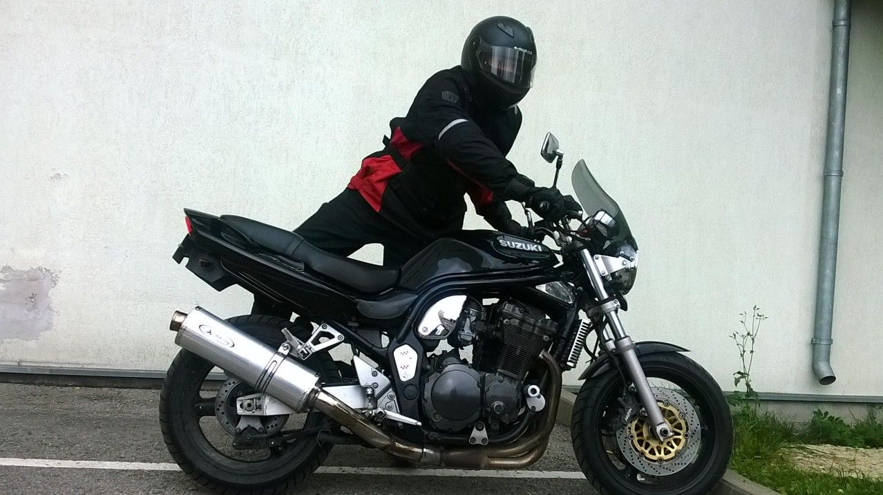

This is the very first image of my bike. My friend is doing test drive

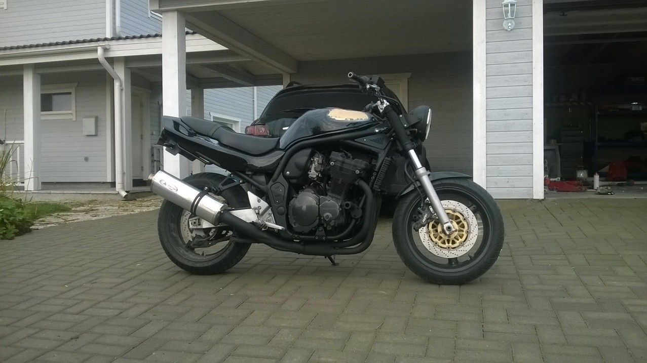

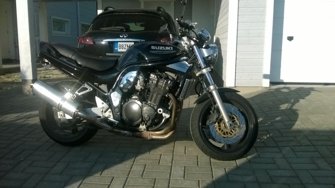

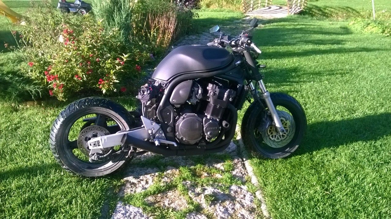

First thing I did was I removed the windshield
Painted exhaust and motor

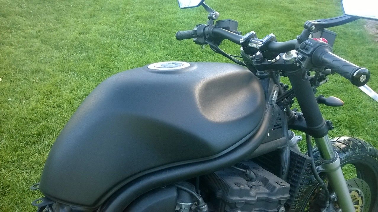

Removed SUZUKI logo that was paited into my tank

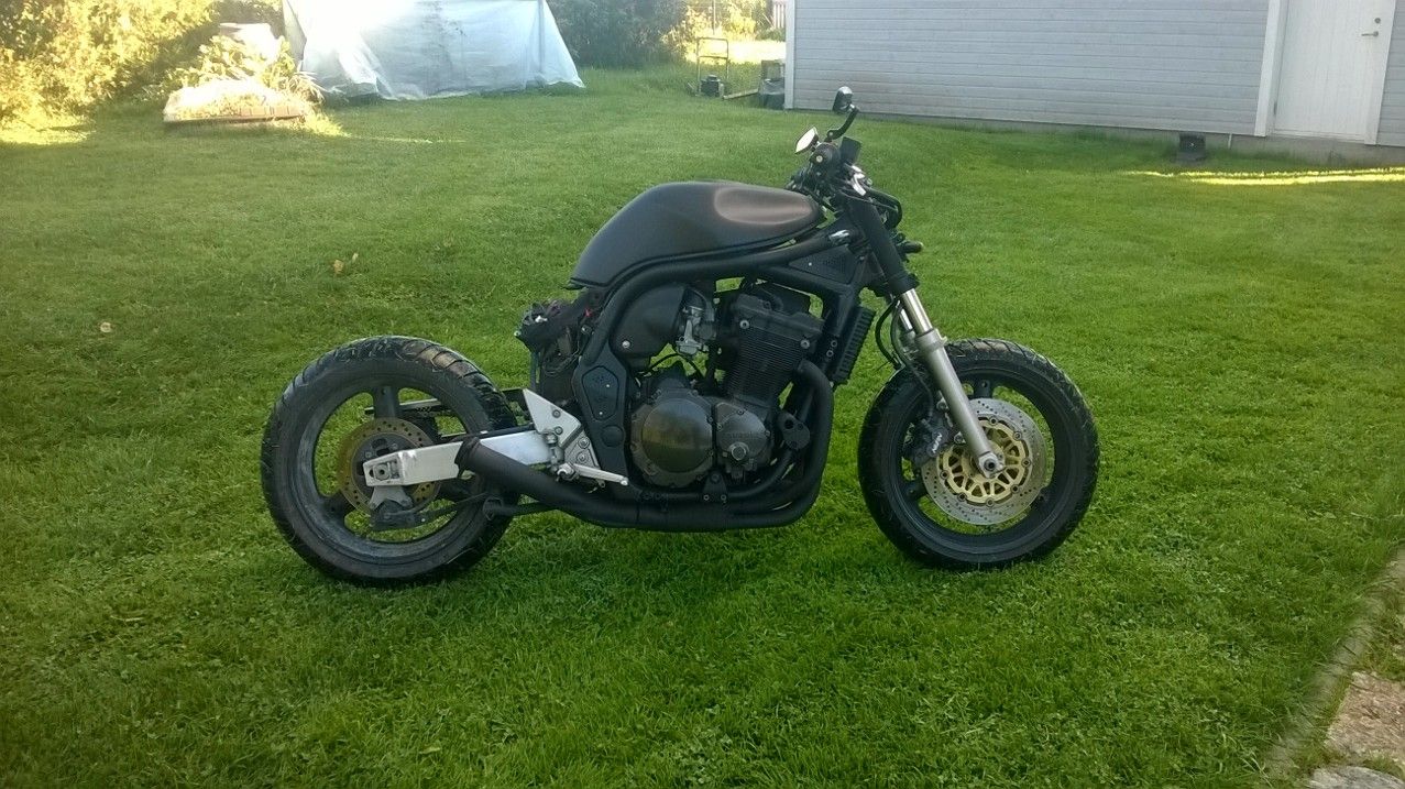

Removed the seat
And cut the tail - frame and body panels color is structured matt black

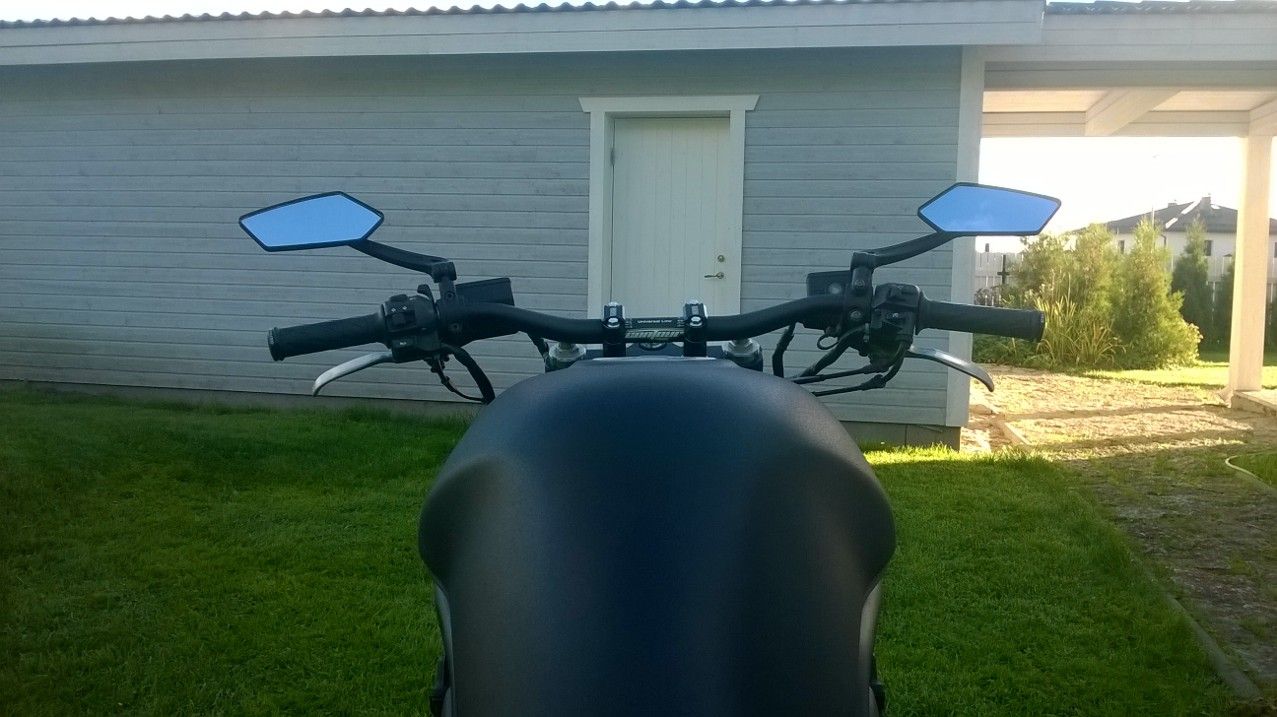

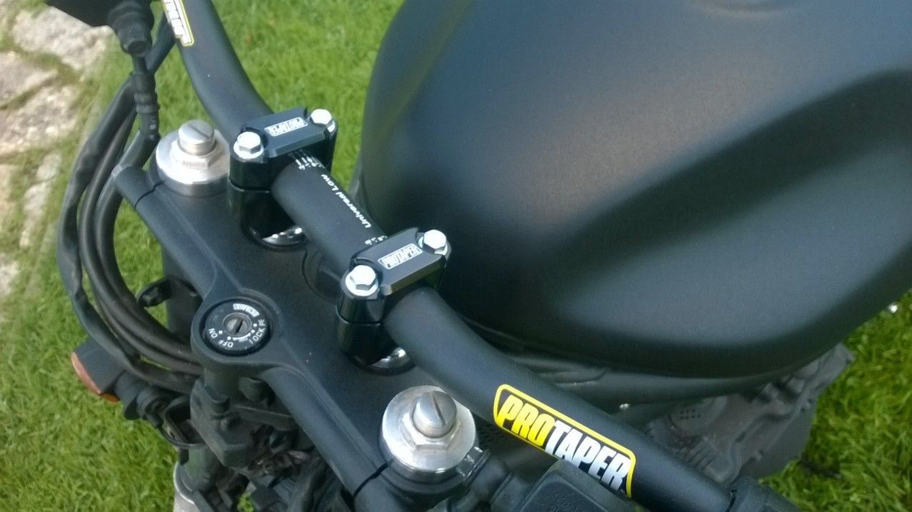

Installed a ProTapper Universal low bar and Yamaha mirrors
