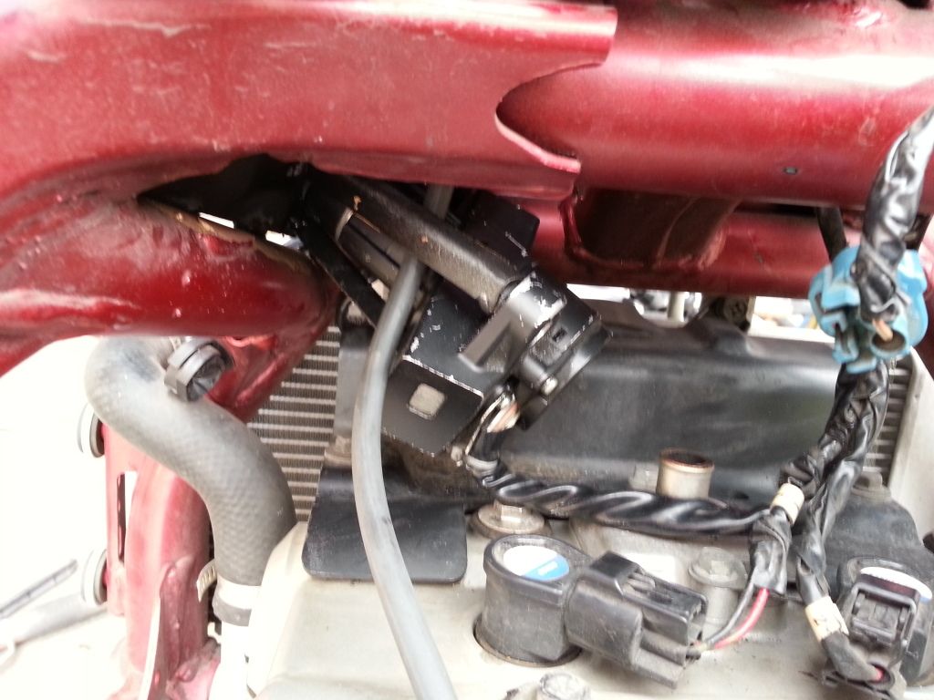

I sawed off the ignition switch from the top triple and mounted it in the open triangle shaped spot up by the neck. Please don't mind the paint at the moment as I am planning on stripping it down once I think i have everything the way I want it and painting everything.

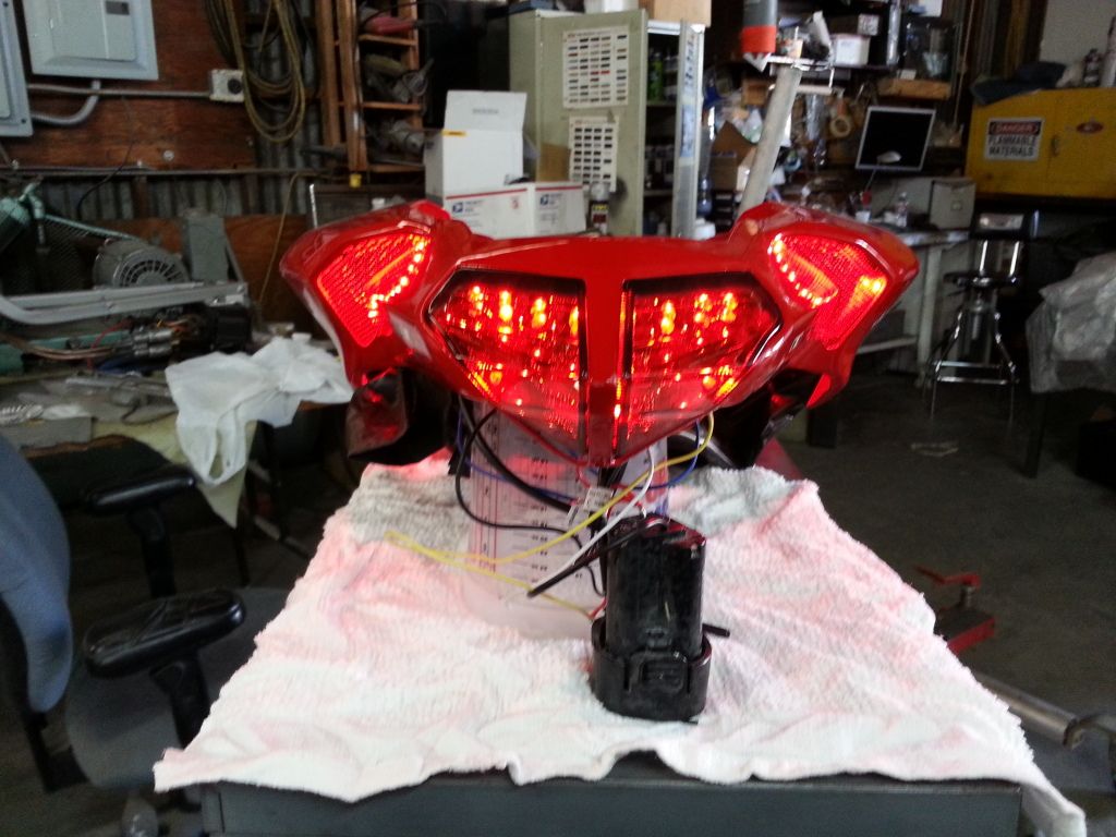

Here's a couple pictures of the tail. I added some led lights inside so when my brake and blinkers come on the vents in the back of the tail section light up as well.The yellow isn't nearly as bright as the brake though.

really like the tail. and the vent lights. a lot. really like the newer swingarm and exhaust too. actually even like the pain the way it is right now, id just paint the tail to match the main frame or the frame to match the tail. but id leave the red and silver offset with the tank and swingarm against the tail and frame. not sure about the headlight though.
