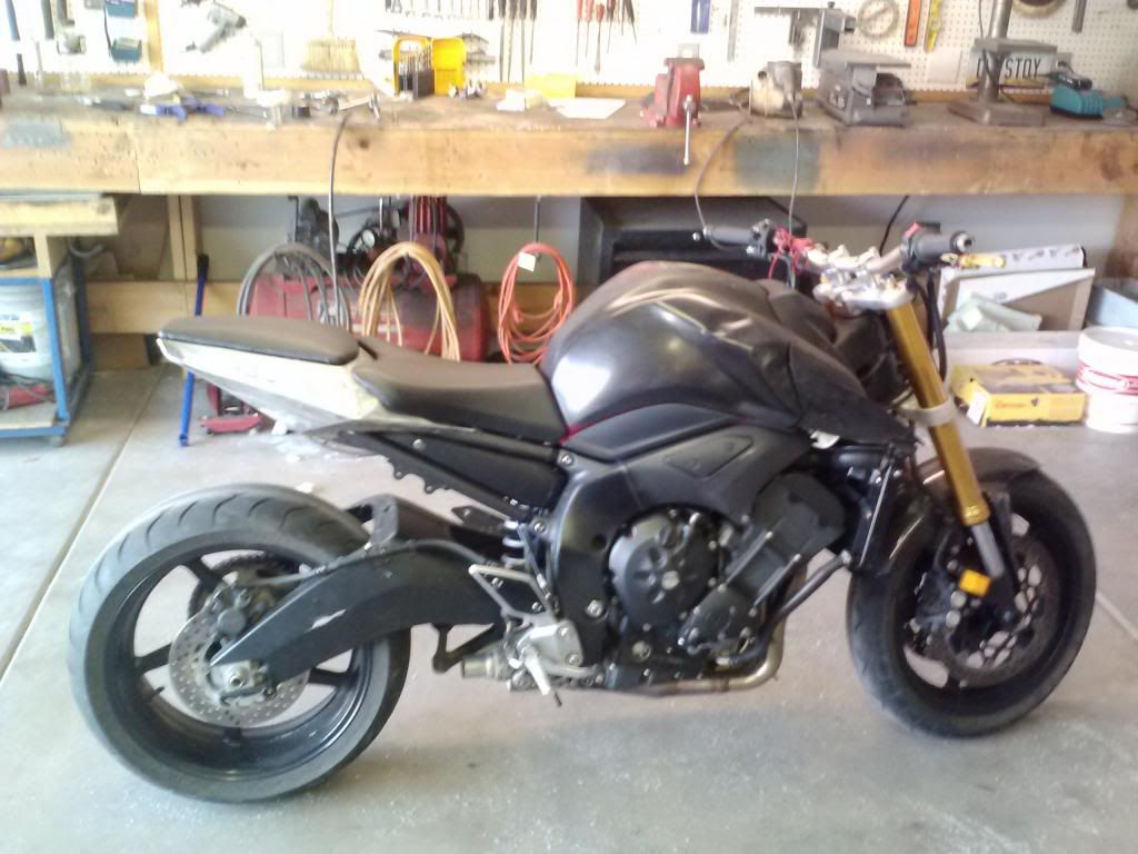

so i got this fz1 today the previous owner hammer it bad hit a deer on and proceded to mod it himself unforntnatly not to much success.heres the bring home pics
and after some stripping down getting it back to a blank canvas

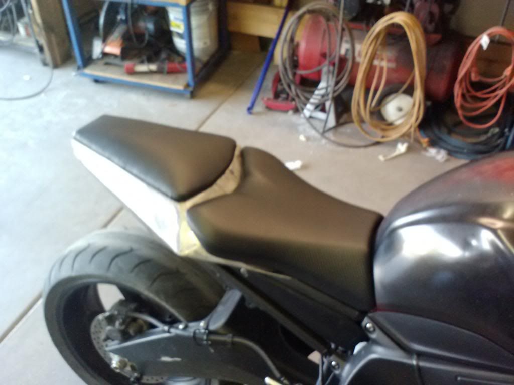

and some of the new tail being mocked up
and heres thefished tail minus filler prime and paint and the new rear seat from scratch,and recoverd front seat
and a few of the head light
im gonna do a custom m4 megaphone down low,ottie moto rears,bar end signals,radiantz intergraters rear tail light,frame and axel sliders,and custom radiator covers,as well as the typical performance mods.pc3,airbox mod,fce,custom exhaust,bmc airfilter,flies mod and cat gutt.

ok sorry for the long awaited update the wife ihas been vacation for the last ten days so i put my head down and really tore in to this bike alright here we go first off i got head light bracket welded and fitted and the lights the way i want.
got my list built, i threw a 4x8 beam in the trusses and ran chains thru drywall, heres before and after i tore her down for paint.
i got my flies modded per copper dawgs spec, my fce installed and my air box moded per lars spec
and here she is with the frame,sub frame,trees,bars,swinger,all recoated in satin black
and i painted tank and cover,also got black billet cap
and heres pics of my finished exhaust,and otti moto rears
and for last my custom helmet lock tabs
well thats it for now thanks:nuts:
sick fabricater
112 Posts
got another up date i got the new tire mounted up in the rear rim painted red rim tape on rear brakes back on fabbed,painted,and mounted the new exhaust hanger,got the modded air box in, got the fuel pump and gas cap in new tank,got new gas tank mounted ,and hooked up,got headlights wired up,i was able to rewire the hazerd flasher switch to trigger a relay to combine the hi beams and low beams, so i have hi beam,low beam,and combined hi/low beam well thats it for now tell me what you think.
