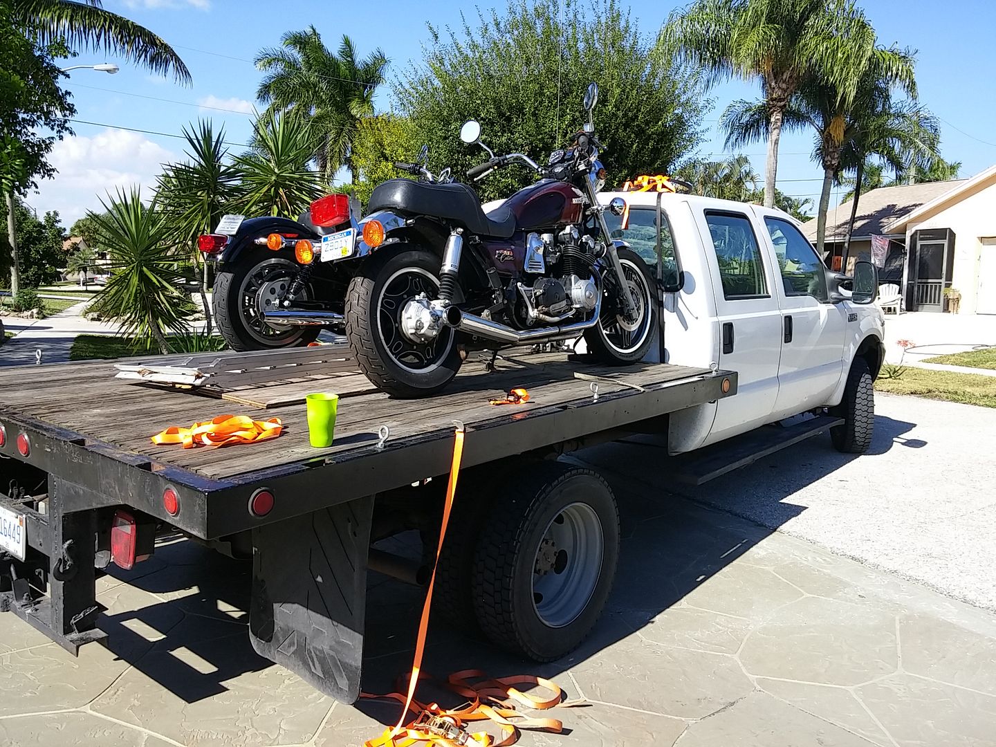

Well, matter of fact speaking. My '82 CB900 is now on the transport trailer and on the way. Yey!
It runs, and apparently runs well according to their listing. Carbs were rebuilt by dealer selling it on Ebay. No dealer fee! Good reputation too - 1533 positive reviews (100%) ... so I believe it. This was their description: "Honda CB900 Custom 1982 in good running riding condition. The pin striping on the tank is a little bubbly. Has very minor tearing on the seat. All under the edges. The engine paint isn't perfect. Has after market exhaust on it. We rebuilt the carbs, new plugs, new choke cable and oil change. Runs great." Additional description, "We have a very nice Honda cb900 custom ready to go.Motorcycle runs and looks good.Rebuilt carbs,plugs,choke cable and oil change.Tires and brakes are in good condition.Ready to ride.Motorcycle is fast.Has low and hi range."
Only 8K miles, I couldn't resist; it was second on my list after the CB750 fell through. Hoping for the best.
Speaking of dealer fees, I almost snagged another CB750 on Ebay from another dealer prior to this one, but in the "fine print" in the listing they stated that a $499 "prep" fee was to be included on top of the winning bid/buy now price. Stupid. Sorry, just stupid. I won't pay that kind of fee. Not on a new car, and definitely not on a used $1000 motorcycle, that's for sure. It's a ridiculous profit booster. That second CB750 could have been a good deal, but then THAT fee AND shipping? No thank you.
Nov 13, 2014 at 11:23am
Got a call from Jimmy (Roadrunner Transport) this morning. He said he should be here around 1:30 or so. And of all the days, I'm alone at the office and will have to shoot out for about an hour when he's near. Such is life.
Also, just to note, he said most every time he stopped for fuel that people would comment on the bike. He asked if it was some sort of rare classic and noted that a few stated that to him as well. Hopefully I got a good one, haha! Dammit, now I may have to not modify it and just restore. Jeez.
Nov 13, 2014 at 4:13pm
And SHE'S HERE!
Little shout out to Jimmy and Debi, owners and operators of Road Runner Transport! Great people, great communication and great care. If you need shipping, contact them first - (517) 589-9126, cell (517) 607-1567, [email protected]
