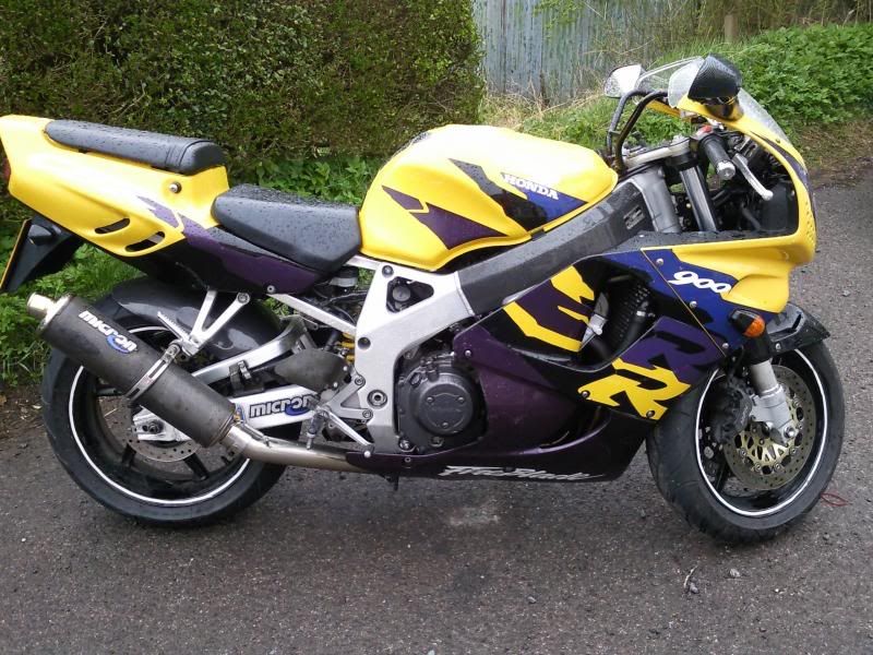

The blade when I bought it.

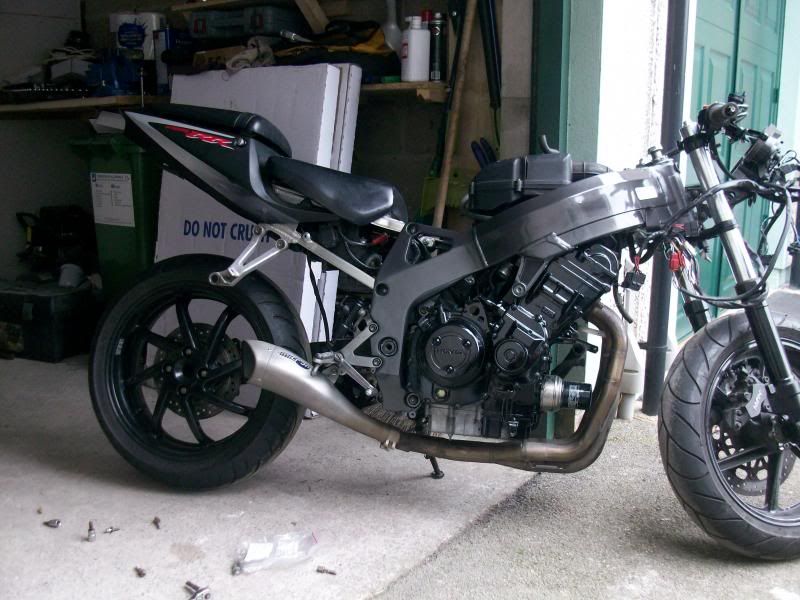

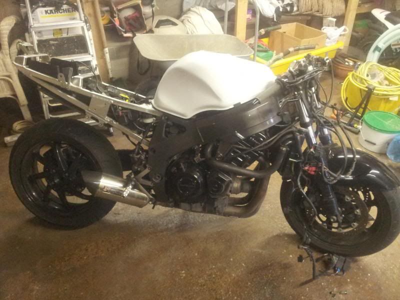

After riding for a while and winter setting in, it's called the lake district for a reason you know, I got itchy fingers.
Rear brake pads needed changed. which obviously turned out to mean i was fitting a single sided swingarm. Which for those looking to do this. You don't neccassarily need the 20mm spacer i made one up when the swingarm was on it's way but I didn't need it. I can't remember which way round it is, but it's either the large pivot bolt from the vfr and the threaded carrier that inserts into the frame and has the castle nut, from the blade or the exact opposite.
As I never thought the older looking bulbous rear end suited the front fairings i started looking round for what did. A 929 cowl came up cheap so I thought I'd give it a go. once on it was obvious it was what I'd been looking for.

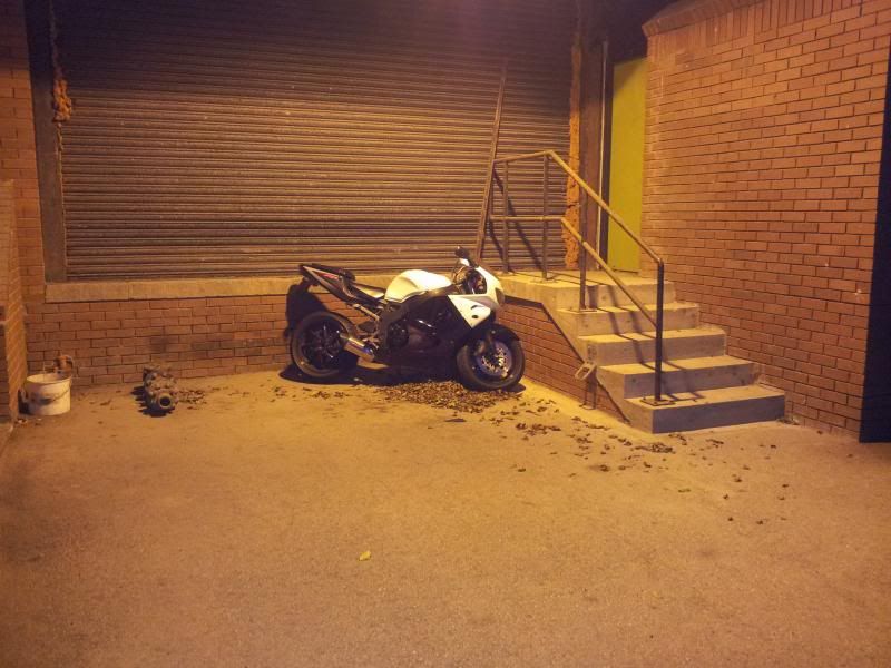

For a good while i road round like this with the cosmetics not done but never since buying the bike did I wanting fairings but couldn't decide. All my mates had sports bikes and I didn't fancy the neck braking wind on longer jaunts up scotland and so on whilst they were tucked in behind fairings. However recently They got cb1000r's and the like, muhahahaha.
