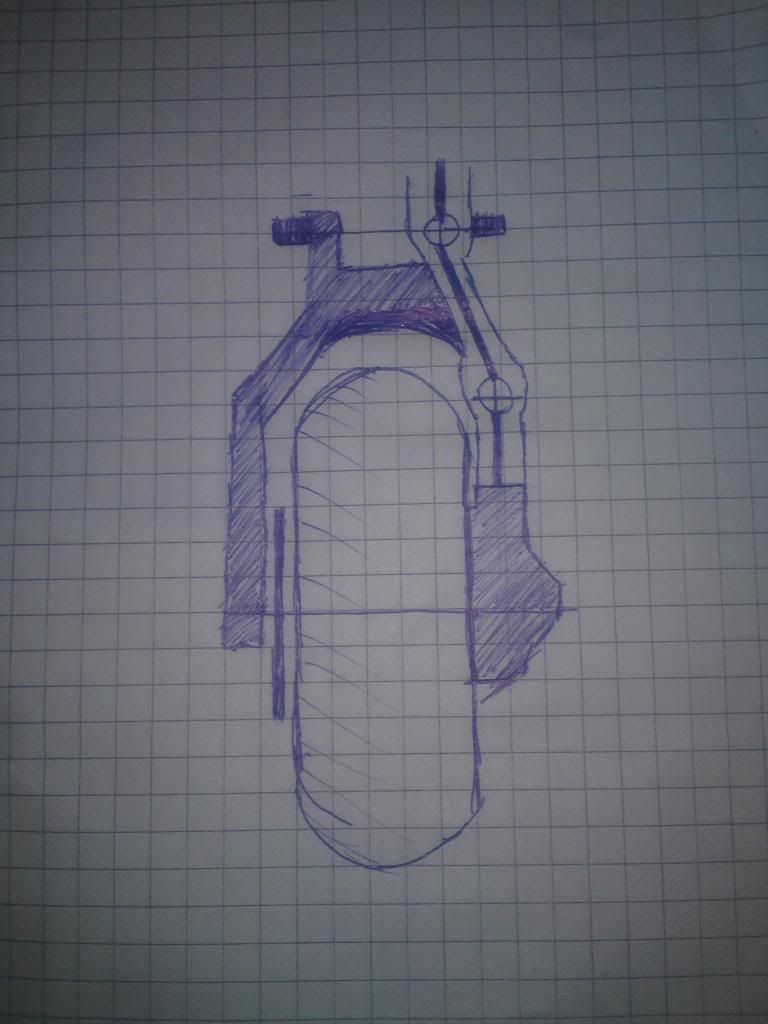

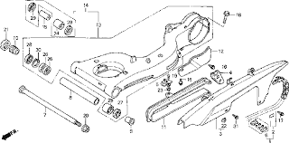

OK,I have a VFR swingarm like this one
Now with the stock rear wheel of course the bike is like this:
(Red line represent the center line of the bike):nuts:
So if I mount a wider wheel ,the wheel get a bit out of the center line of the bike
Will this effect the ride on straight ?????
1 - 19 of 19 Posts

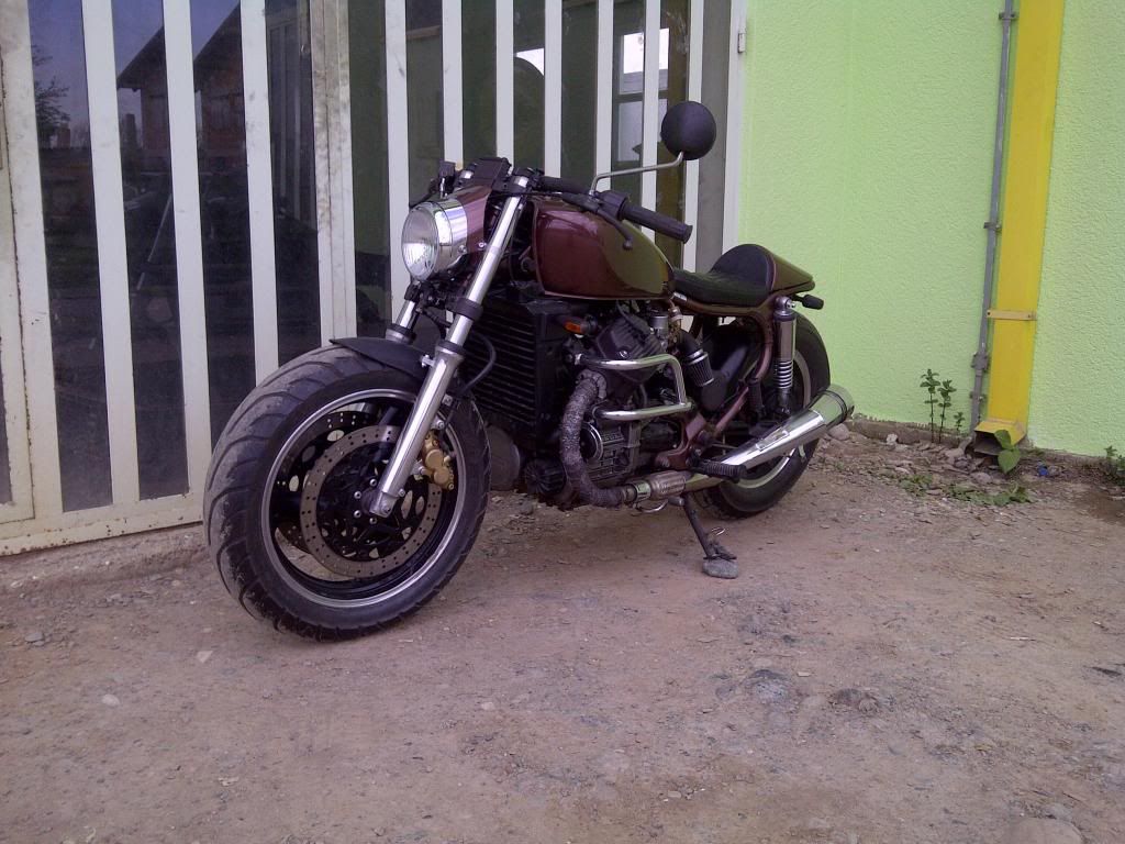

I made this question for my modified Honda CX 500 that i posted in an other forum
Exacly this one
Now for now in the front i have an 140 and on rear i have an 130.Since the the bike is with drive shaft i cant play much with it so i am trying to mount a 180 or 190 on the back.so if i understanded the rule (english is not my first language) I get 20% or 20mm to move it
RIGHT?
Exacly this one
RIGHT?

I will not go with the VFR swingarm cuz the bike is with drive shaft
My first thought was to make this kind of swingarm with two joints but I not sure
Now I think if I let the drive shaft straight and can get a small offset I'll do it
