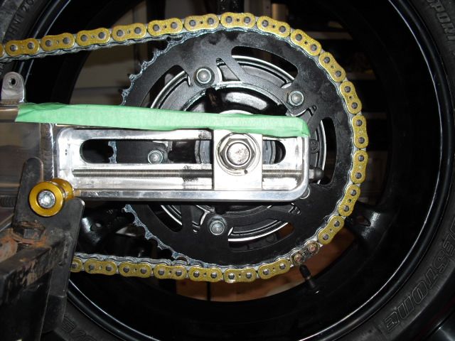

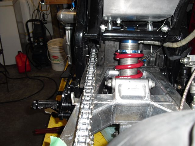

Hi all.Finally got this buttoned up as far as the build goes.Sprockets arrived and fitted up.Gsxr rear wheel fitted with top hat spacers for smaller axle.Had to flip the gsxr sprocket so as it sat inboard for the chain run to be right.

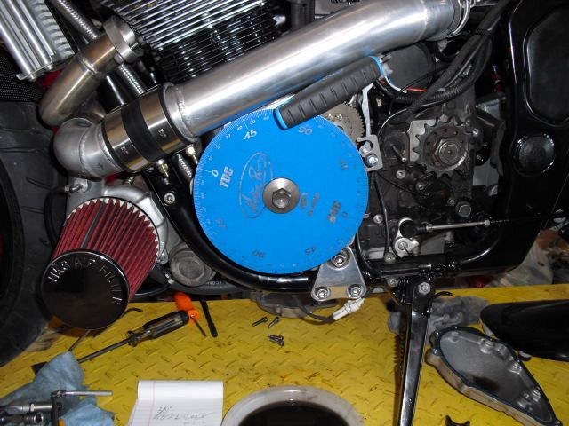

Checked the ignition timing as I did not trust the chincy bracket that dyna gives you.Good that I did cause the dyna bracket markings were a couple of degrees out.

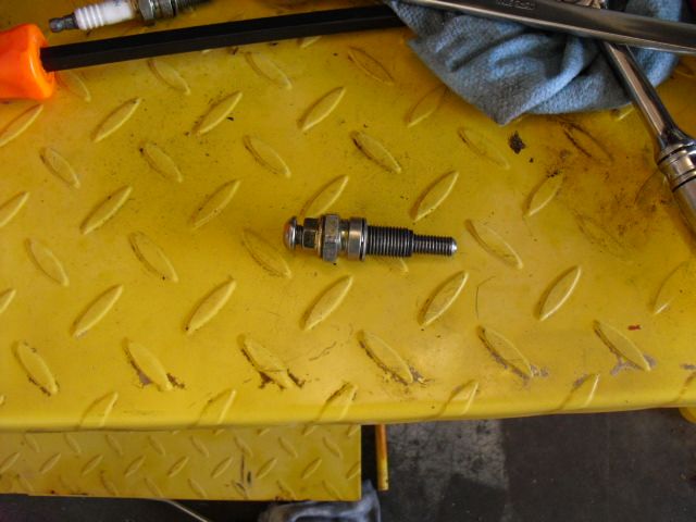

Home made piston stop.
Checking timing.
Vortex steel sprocket and 530 zzz chain.
Straight chain run and rebuilt/resprung Fox shock.
