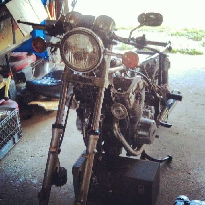

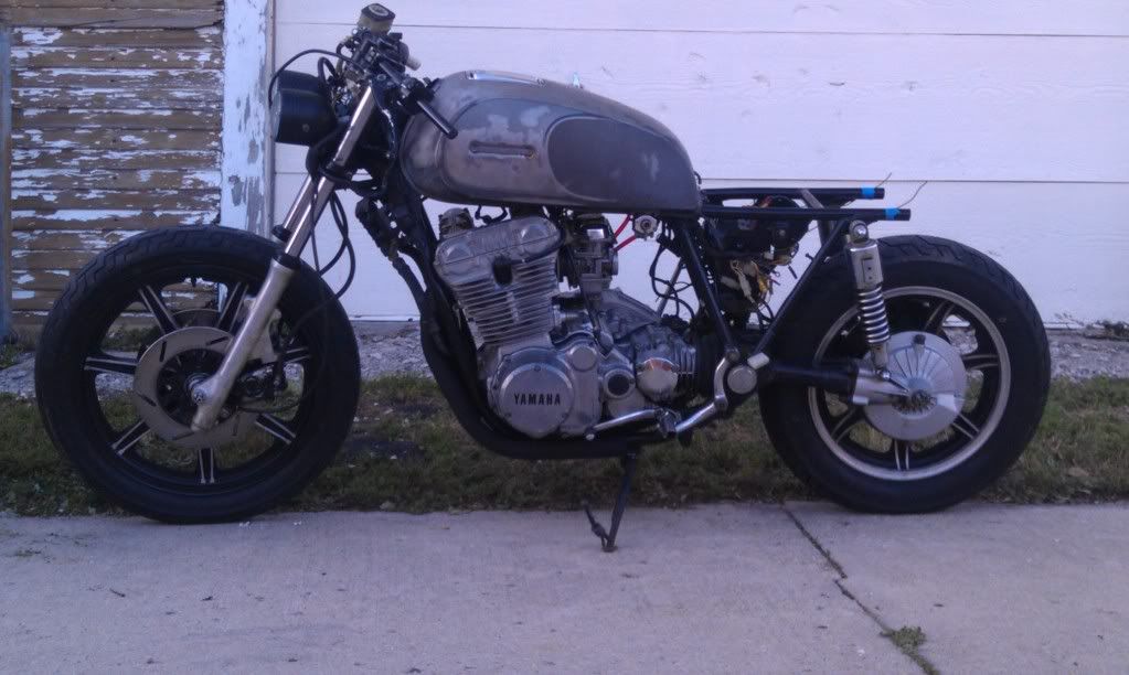

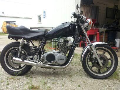

So this is my 1980 yamaha xs850. I bought as is in the first picture. This is some stuff I plan on doing. Monoshock, r1 seat section, r1/r6 front end, relocating battery.
