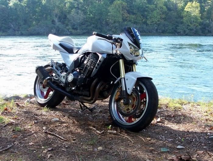

Started out with a bone stock 2003 Kawasaki z1000. I set about ditching the dirty bars and building a custom exhaust. Then, I added a K & N filter, integrated taillight, and some blacked-out panels.
Rocked it like that for a while, but soon grew tired of the red and black. Had it painted Alpine white with several layers of blue and red metal flake. Added pazzo levers, billet case sliders, stainless brake lines, spike bolts, and a few other goodies.

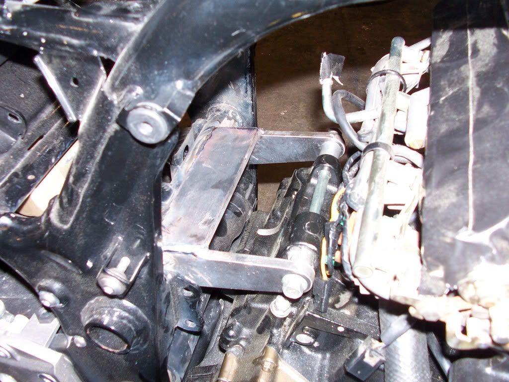

About $1700 later.... and I had a complete 2005 zx10r engine kit to go in. Took the bike to a friend's machine shop where we started making the new mounts.
Mock-up:
Actual progress:
Everything lined up and ready for new front mounts:
Front mounts done:

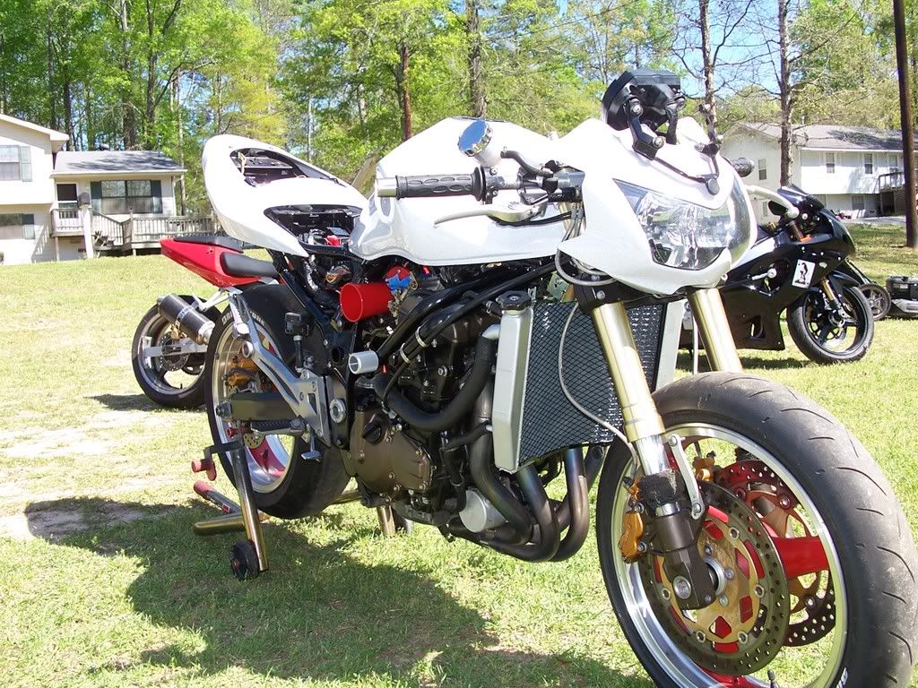

The day before some friends and I went up to the Dragon... my front fender came back from paint. On the trip back home... I realized that I could sure use some higher / nicer rearsets. So I started searching the world wide web for a good deal. Found a set of Speed King rearsets on another forum for 150 bucks, but they fit a zx10r. Who cares right? Quick call and paypal later... they were on the way.
While I waited on the rearsets to arrive, I changed my oil and did some regular service. However, while I had the tank off... I noticed that the UNI pod filters were FALLING APART! WTF? So I decided to go custom with that as well. I bought 8 of the same radiator hoses from 5 different auto parts stores. Bought some thin wall aluminum tubing, and two K & N pod filters off of Ebay. A quick cut here... a hose clamp there... and VOLIA!!!
Rearsets came in... so I started making then fit. Drilled and tapped a hole in the frame and bolted them up. The shift linkage fit perfectly, as did the brake master cylinder and hose.
