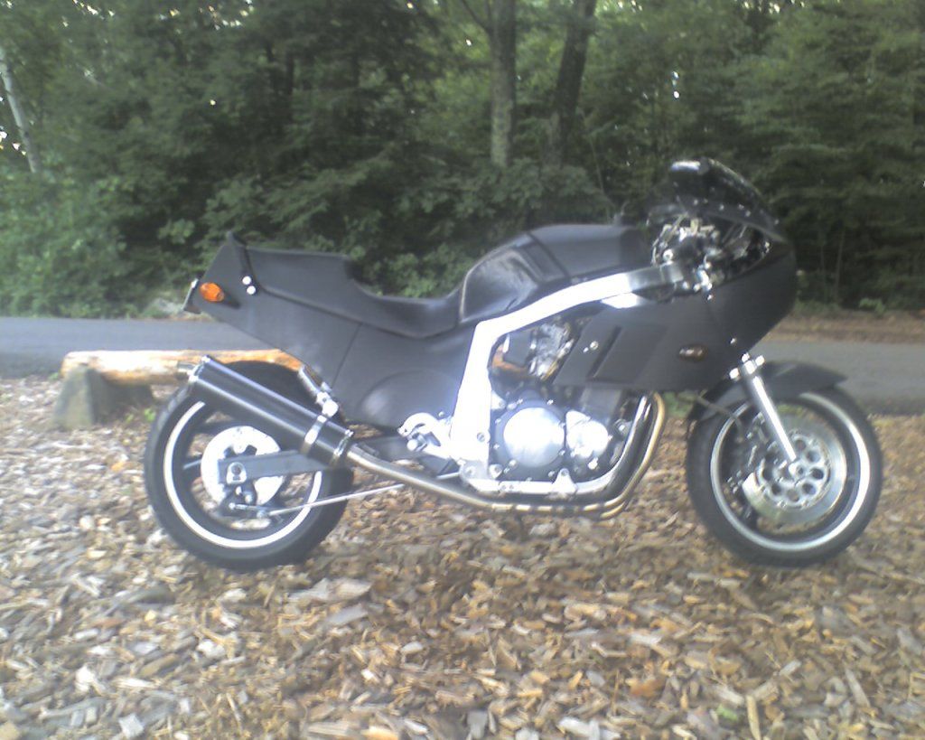

I bought this bike, bone stock, 22 years ago
Rode it for 1 week. Wrecked. Hospital. Fixed. Wrecked. Started customizing.
50,000 miles later:
86 GSXR1100
1127cc slingy
RS36 flatslides
stock swinger stretched 5"
cut tranny
89 1100 front end
91 1100 wheels
Fox twin clicker
custom made seat
Pingel petcock
6 pot tokiko brakes
Hindle SS pipe
Airtech fiberglass fairings
Commander Cool
9,707 Posts
not the biggest fan of the extended swinger but I understand the reason behind it.. this is a fucking nice bike. very fucking nice.
Hack in a barn
4,409 Posts
I'm subscribing for the money shot on that JMC swingarm, they are a work of art!
Good looking bike man!
53 Posts
Looks like you have some good plans. I'm ok with extended swingers on big engine bikes 1k or bigger so I say go for it.
I know it doesn't look it, but it's already stretched 5"
Funny thing about the slabby tail ... it seems to look more natural stretched.
If anything, I'll make it an inch shorter once I mount the adjustable JMC.
I'll never go back to stock length again. Way too hard to keep the front wheel on the ground :)
