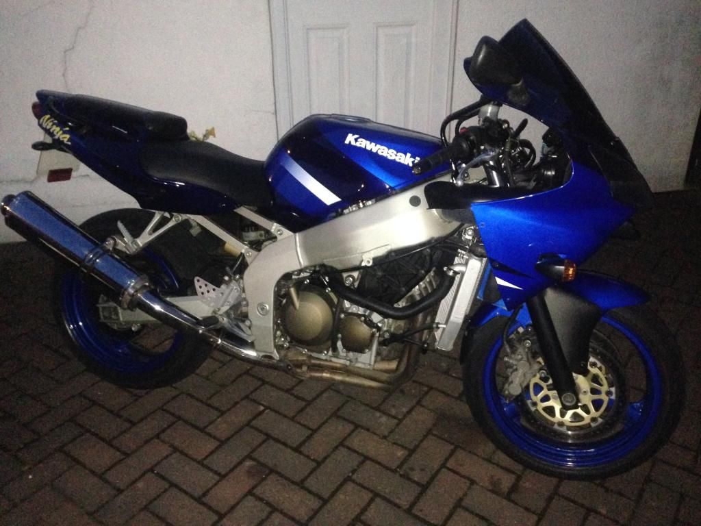

Decided to start another project this year so brought a low milage zx6r

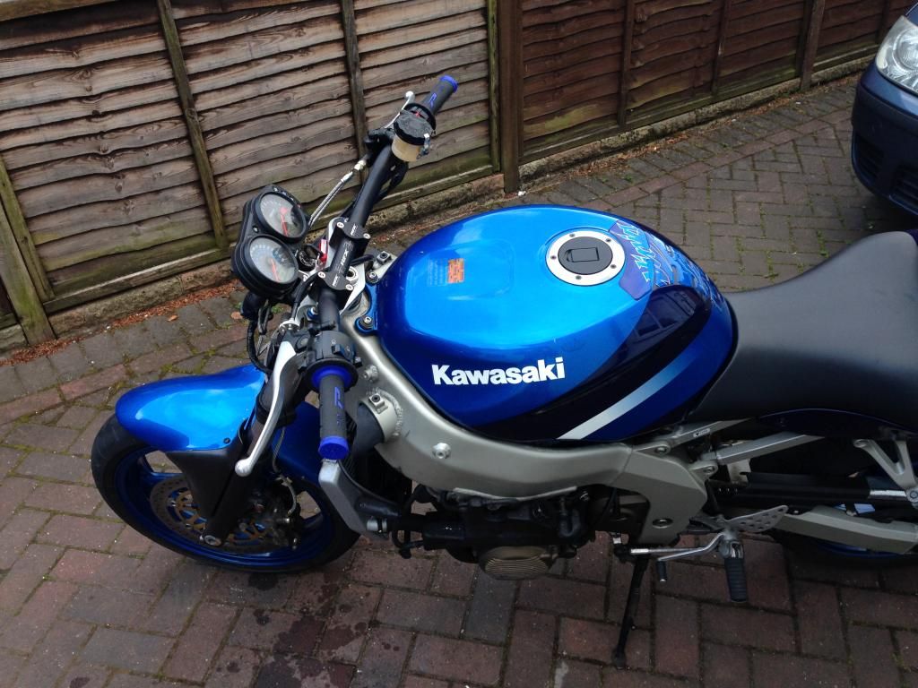

And started removing all the plastics

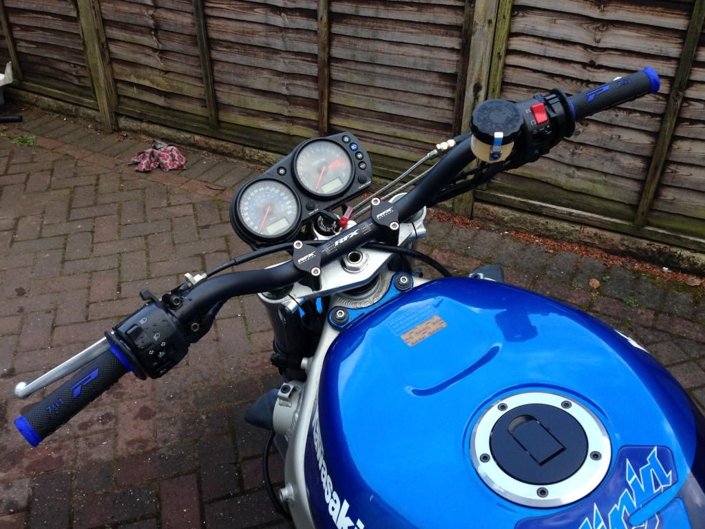

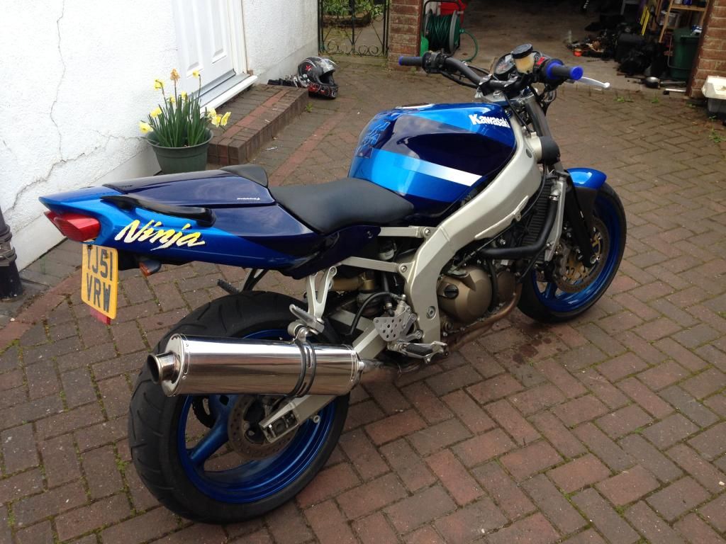

Then I brought some fat tapered bars and some clamps which same as last time I drilled through the top yoke, flipped it upside down and filled it with resin, and put a plate on the back and bolted the clamps on, I fitted a braided line because the standard one was too short.
That's as far as I've got next up is a headlight and mirrors, pics to follow
