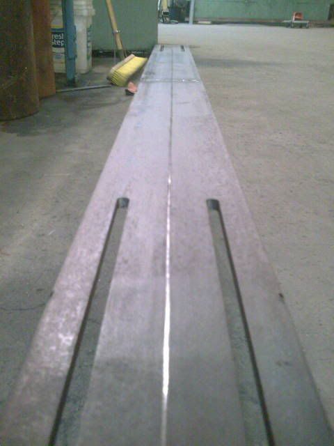

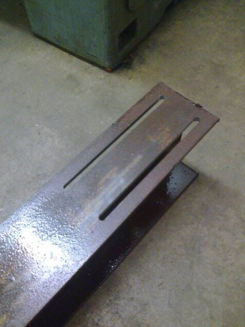

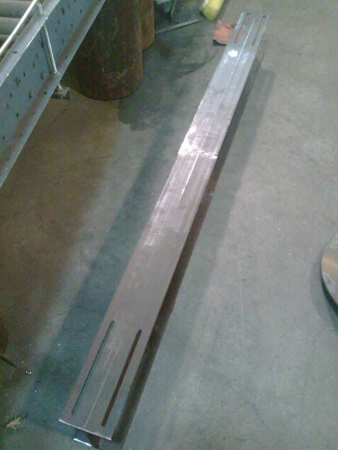

Anyhow, here's a pic of the jig I started last week. Need to get some tube for legs, and build the neck/axle plate towers and we're rollin.
Also, I'm gonna be building an engine carrier so I can bolt a sportbike motor up here and build perimiter parts to see what I think.
Anyhow, here's the first day of work on the jig:
I'll be rockin soon here. I charge under $1G for a fully custom built frame. Includes standard axle plates and neck gussets. Above that is alacarte. (Custom plates, goosenecks, etc.)
I never got into building fuckloads of frames cause I liked doing it as a hobby, but it was a good time. Who knows? Maybe I'll quit my job, make 3 frames a month, and spend a shitload of time with my kid? lol
Anyhow, if anyone was interested in building a jig I'll keep updates coming.
FWIW: The beam is a 5" 24# or so. I didn't weigh it. It was two pieces of scrap outside at work. I took out 2 3/8" slots at 3" between centerlines 18 inches long on each end. Then I scribed off a center on the two pieces. Lined them up with a long piece of angle iron, tacked it, clamped some 4x1" bar along them and welded the seams. Perfectly straight.
When building frames centeline along the length of the frame is the most critical measurement... so I always cut a permanent CL down the length with a thin cutoff and a grinder. Gives you a constant reference.

Update quickly. Added legs and wheels.
Legs are 20" long. Feet (if you call them that) are 24" and the wheels are 3" castors made of rubber. The one end is a set of swivels with locks.
Anyhow, here's the pics.
Critical thing is that everything is as square as possible at the frame side of the jig as a out of whack jig is worse than no jig at all... The legs should be squared too, but I'm running adjusters in addition. I got it square, but adjusters will help level.
