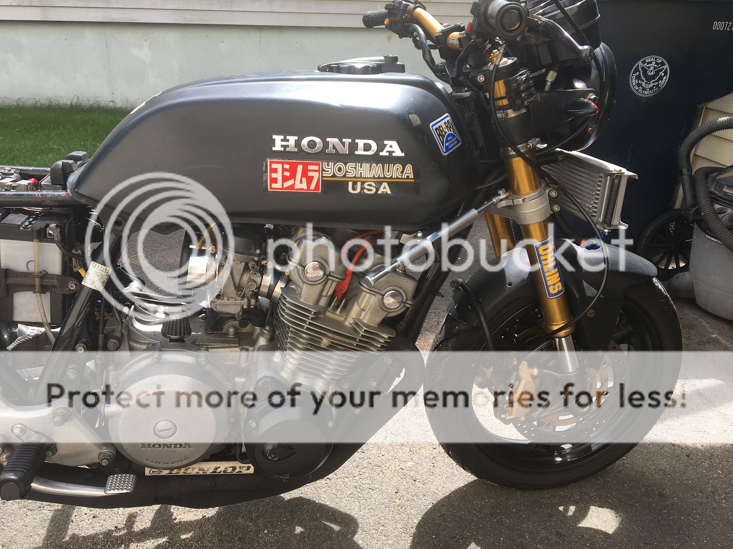

So i lost some ground clearance with the new pipe and didn’t want to bash it in. So i had Seb at SebSpeed customs make me a new top triple with a 2” step. Got me to 4 and 1/4 clearance which is just about we’re the yoshi was and i never bottomed out with that. Should be good to go. Thanx Seb. If you guys need parts made, Seb is top notch :D:D
