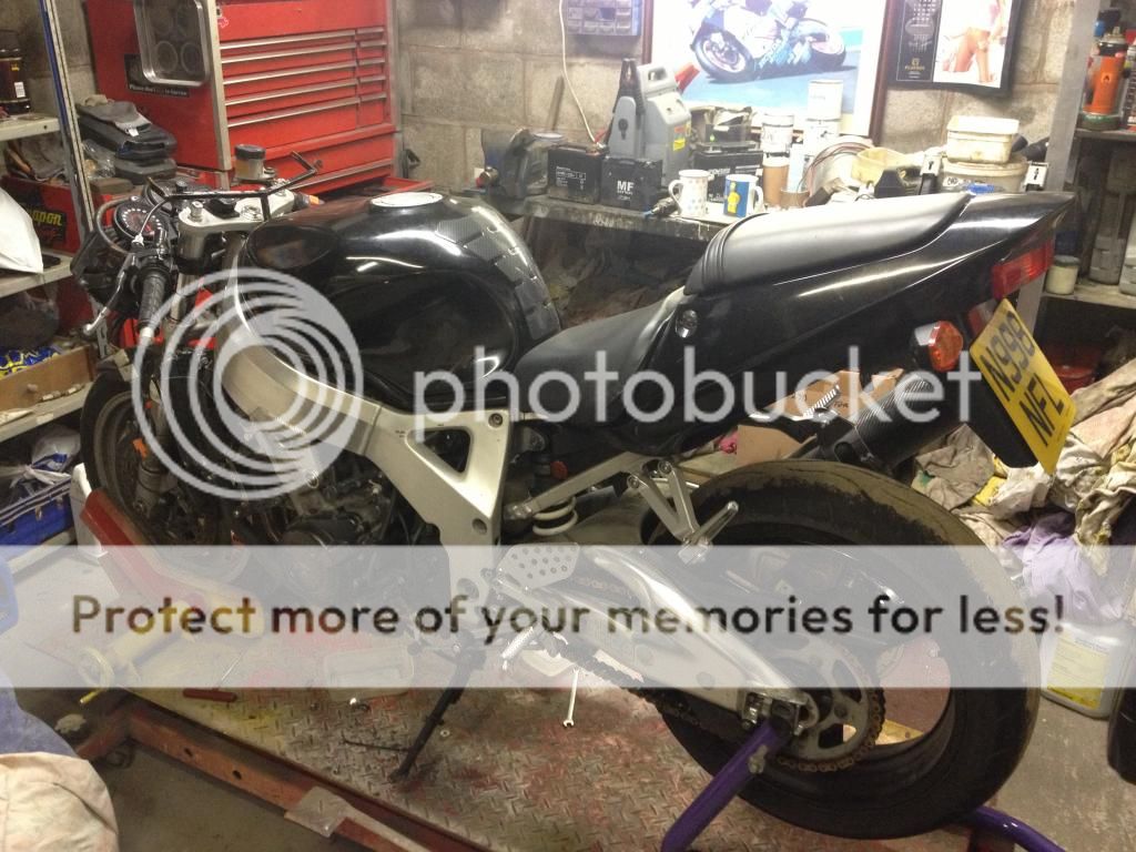

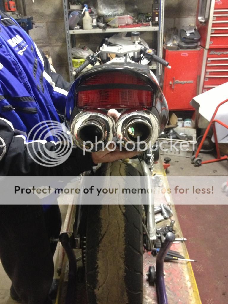

As promised everyone....The stripdown ready for the fighter build started yesterday evening. First started by stripping all the bodywork & lights etc off her to get a blank canvas for want of a better saying. The tail unit is staying 929 blade as i love the look of it, the subframe is being modifyed to accept a pair of round stainless steel scorpion race cans, and i am putting it back to standard gearing instead of the 48T rear sprocket currently on there so it cruises much nicer and i can attempt to get some traction.

#4 ·
That bike is a real mixed CBR bag, eh? Did you average the age of the parts on it to get '96? The frame is certainly older than MY '96 (CBR900RRT). Do you have much provenance on it? I'd be slightly concerned it'd been in a crash.
In these pics I see, as well as what you've noted:
92-95 frame (central triangle shape) with matching year/type single bolt tank
00-01 rear plastics
96-97 or 98-99 918cc engine (3-bolt clutch cover) show me the hoses below the carbs and I'll tell you which MY
98-99 yokes (alloy, twin pinch bolts at bottom) therefore also longer axle
96-97 or 98-99 forks (silver bottoms) depending on if for 296 or 310 discs
98-99 clocks
92-97 calipers
92-95 front mudguard type and brackets
I also see a race 4-1 instead of 4-2-1 exhaust and a race shock, maybe WP.
I am excited about this build, will definitely be watching!
#5 ·
The frame is a genuine 1996 UK frame the last of the single bolt 893cc. All documents and numbers match and has never been in a crash etc as I have all history, HPI check and previous MOT's etc with it. The rear shock is rsv mille Showa, the tank, forks, yokes, foot pegs & hangers, front brakes and motor are all 98-99 919cc blade, the headers are Yoshimura full race jobbies as was the rest of the exhaust which is being replaced.
It is a very mixed bag and totally unique as such, however as a super sports/race bike I did not enjoy it on the road as much as the cagiva raptor 1000 I was riding previously hence why I am fightering it to make it more fun.
#9 ·
Front brakes on it are deffo not 98-99. They are the batwing calipers which are 92-97.
Just really worth noting in case eg you want to buy pads, seals or a dress up stainless bolt kit etc.
Got to note the difference between the year it was made an the model year it came off. Same as the frame it's deffo model year 92-95 even if the bike was a 96 reg.
Anywho, looking forward to updates!

Made a start cutting the subframe to be able to route a mockup of the new exhaust pipework and had a little bit of practice pie cutting exhaust tube and tig welding it up. Now for the first time i have autonomously welded anything i dont think it has come out too badly at all. Its dirty mild steel so the nice shiney ultra clean stainless steel should be much nicer.
And ive also added some pics we had done last year of a few of our other toys including my Dresda Honda CR750 racer and my dads Spondon Yamaha TZ750 racer :rock:
Enjoy
The above pic shows the clearance i am working with routing the exhaust up through the swingarm and past the top of the shock reservoir. I think some heat wrap may well be required!
