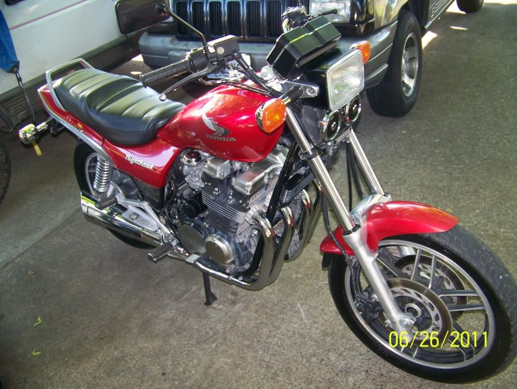

I have a 1984 Nighthawk 650 shafty.....I have had the bike for a few months now and just got my last ride in today. Decided it was time to start tearing it apart. i posted a couple thread of it before but were in the wrong section, so im doin it in the right spot now.
Here is how she was when i got the bike

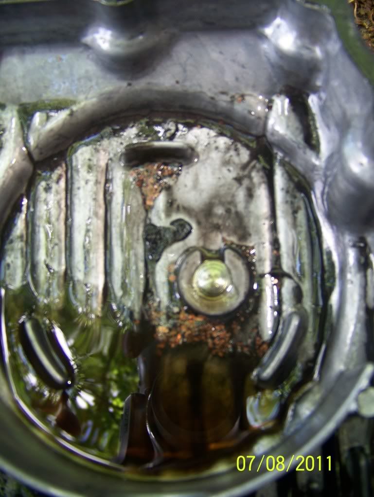

After about 2 days into owning the bike i heard a nasty noise from the engine, turns out it ate one of the crank shaft bearings and i started saving up money to get the parts, got a new crank/rods/bearing.....well mostly new, they had about 4k miles on them...and i started getting swamped at work so i had no time to work on it. I took it to a shop to do the labor cause i was just gettin frustrated looking at the bike. Couple weeks later they had the bike done and gave me a $788.Fuck Me!!!!! I would have just done it myself they quoted it around $400. But it has been doin great since.
here was how i found out it was a bearing

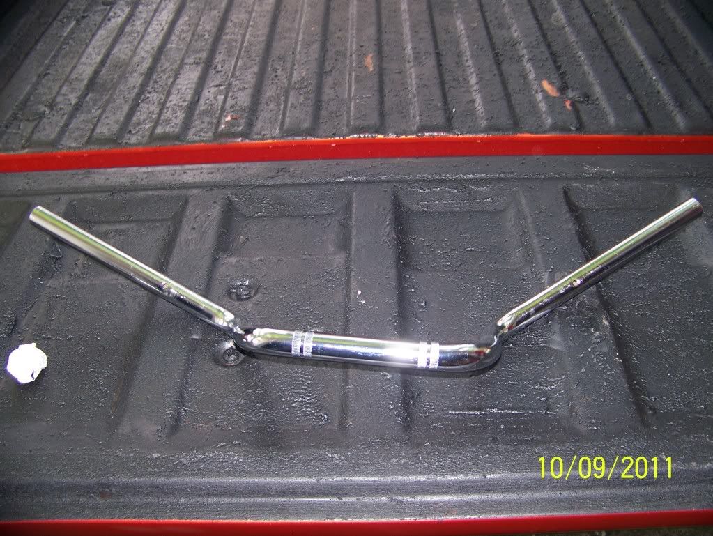

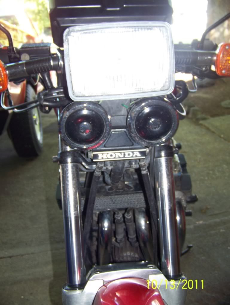

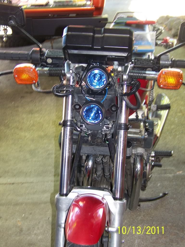

I laid the bike down in the fall due to my own stupidity but i had all my gear on and only have minor rash from layin it down, The bike was pretty good except the handle bars were efffed and couple scratches here and there and a busted headlight, I put a couple cheapo autozone fog light on it and the actually gave me better visability than stock

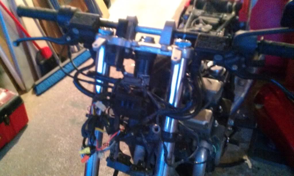

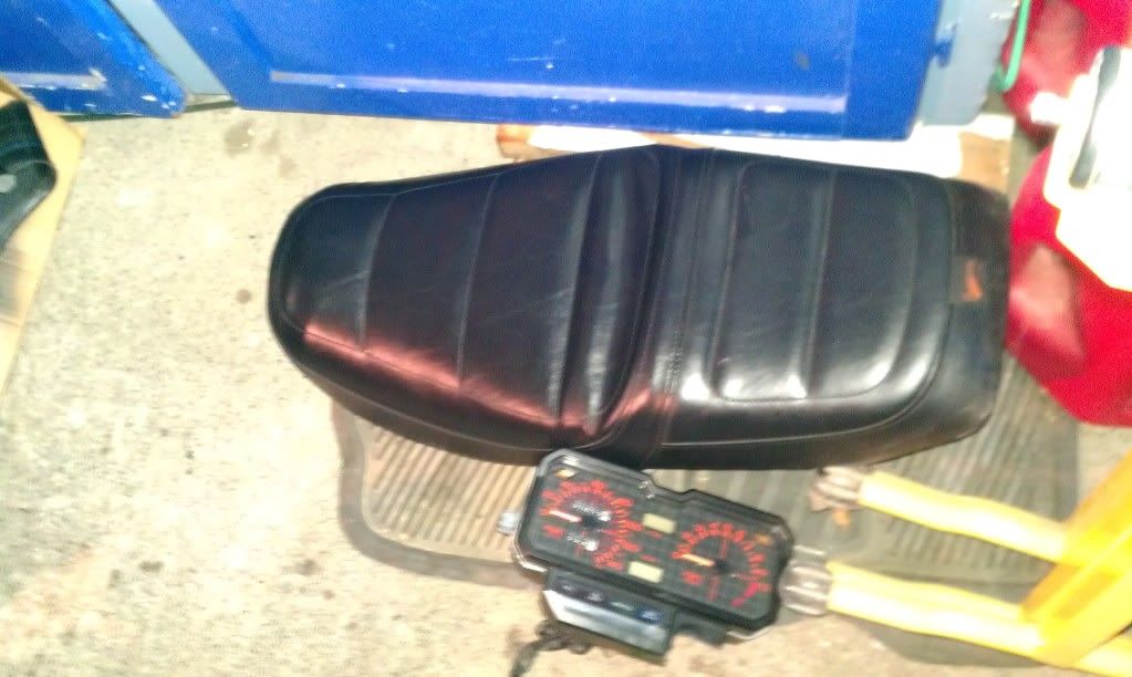

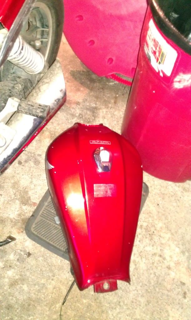

Today i started taking all body related pieces off, tank,guages,seat,tail in about an hour and the only electrical problem i am having is my blinkers arent working, But I have no idea where to go with the bike, a cafe would be nice but im 6'4" and dont want to be cramped, I want a 919 or cb600f tank on the bike and started tossin around the idea doin a bobbed style seat with a z100 steat, but i would be raising the seat height also

The black tape helped the bars fit in nice and tight haha.
no reason it say south Africa. Bought it with that on it and it happened to be center. Clip ons will also be one of my additions.. more updates tomorrow. I plan on tracking down where my blinkers got messed up then hack the subby up

I have some pics on Photobucket. When I get home I will post them up for ya. It was pretty simple. And they hardly drained the battery. I amlucky cause I have never had much trouble with the electronics on the bike but it has died at a gas station once
#8 ·
Here you go mdange2011
:thumbsup::thumbsup::thumbsup:
i just used crimps with solder in em and use heat shrink tubing to seal it in
I had both grounds goin to the single original ground and stripped the high and lo beam wires, lo beam to the low light and high beam to the higher up one, Had both on at a time at first but didnt want to ask to much of the nhawk cause of the shotty charging system
be warned the original wiring is a bit of a clusterfuck i took out about half the wiring by cutting out unneccesary lenght and then solder the wires back together

Progress today. I got a new flasher relay and fuses. And my blinked will turn on now but won't flash.

ok, so a little progress on the blinkers, got a new flasher and fuses yesterday and now the blinkers will turn on but still wont flash, they just give a dim glow, im also looking for a wiring diagram for my stock gauge set up so i can use the connections and wire in the new setup to fit perfectly.
This is the best diagram i have found so far http://www.myhonda650.com/images/cb650wiring.jpg but it doesnt show anything for the gauge pin setup at all

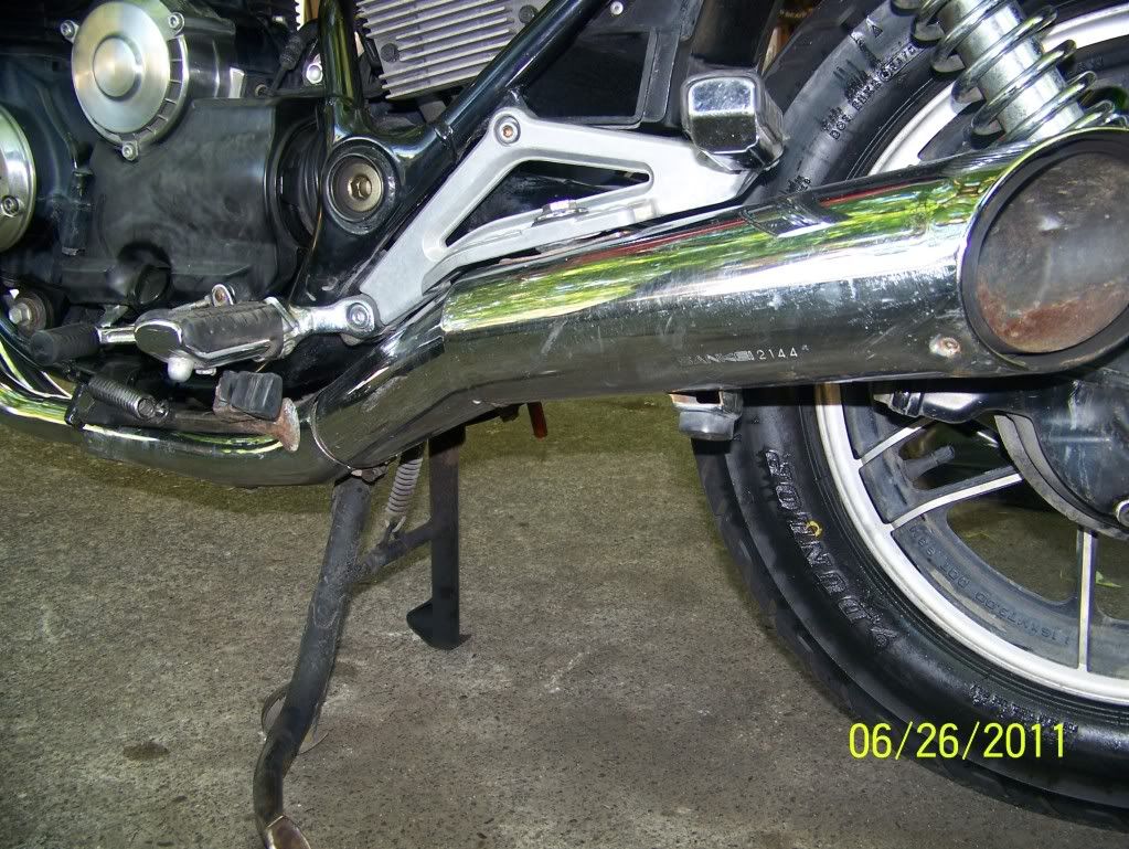

I checked out a few today, thanks that will help me. I went out to the garage to grab a couple beers and saw the bike just sitting there and had to do more work on it, so... i decided to take the shocks off
and clean em up, i want the bike to have a higher stance also, in the rear, so if i were to get a solid piece of aluminum or dog bones could i mount the bottom of the shock where it is in the pic^ with out any problems from the shaft drive? Also the other shock bolt was hiding behind one of the mufflers so..............i decided to take off the exhause and clean it up soon, and hopefully get some new muff on it before i have to reinstall it
