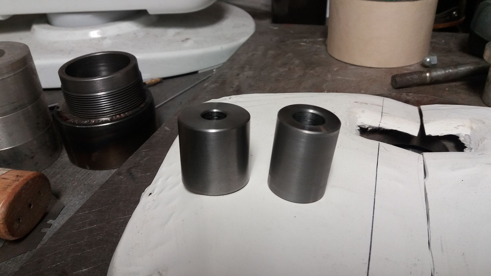

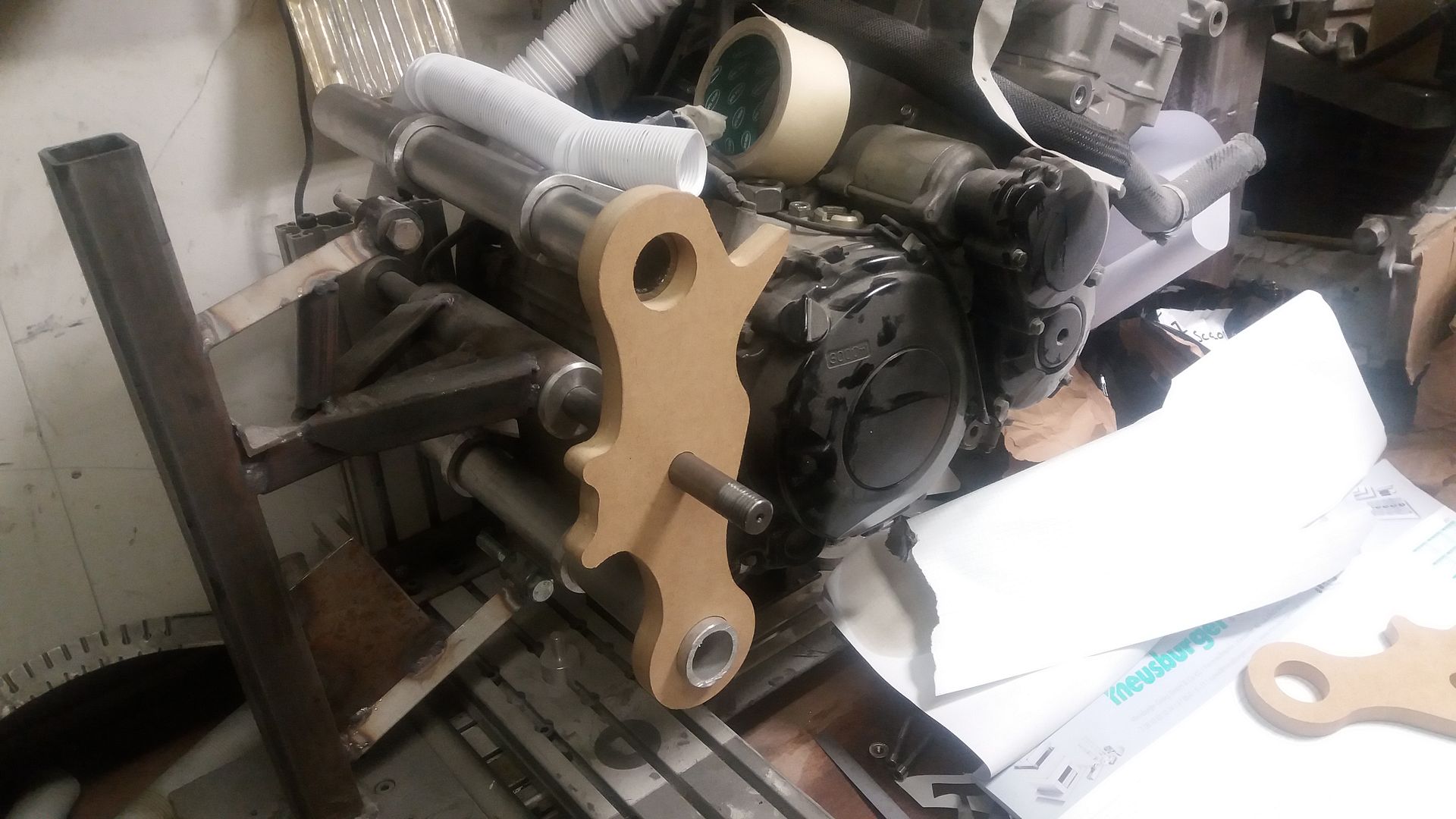

a pair of sleeves turned up for the swingarm spindle

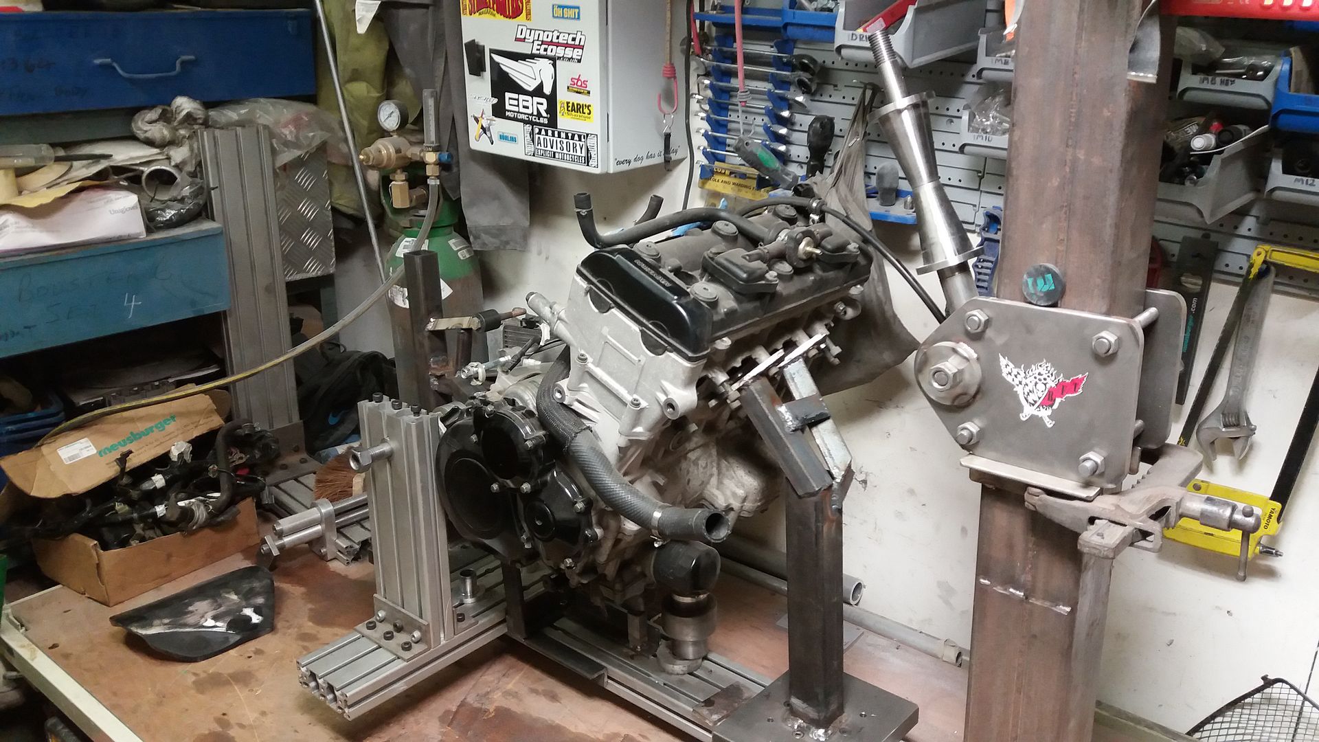

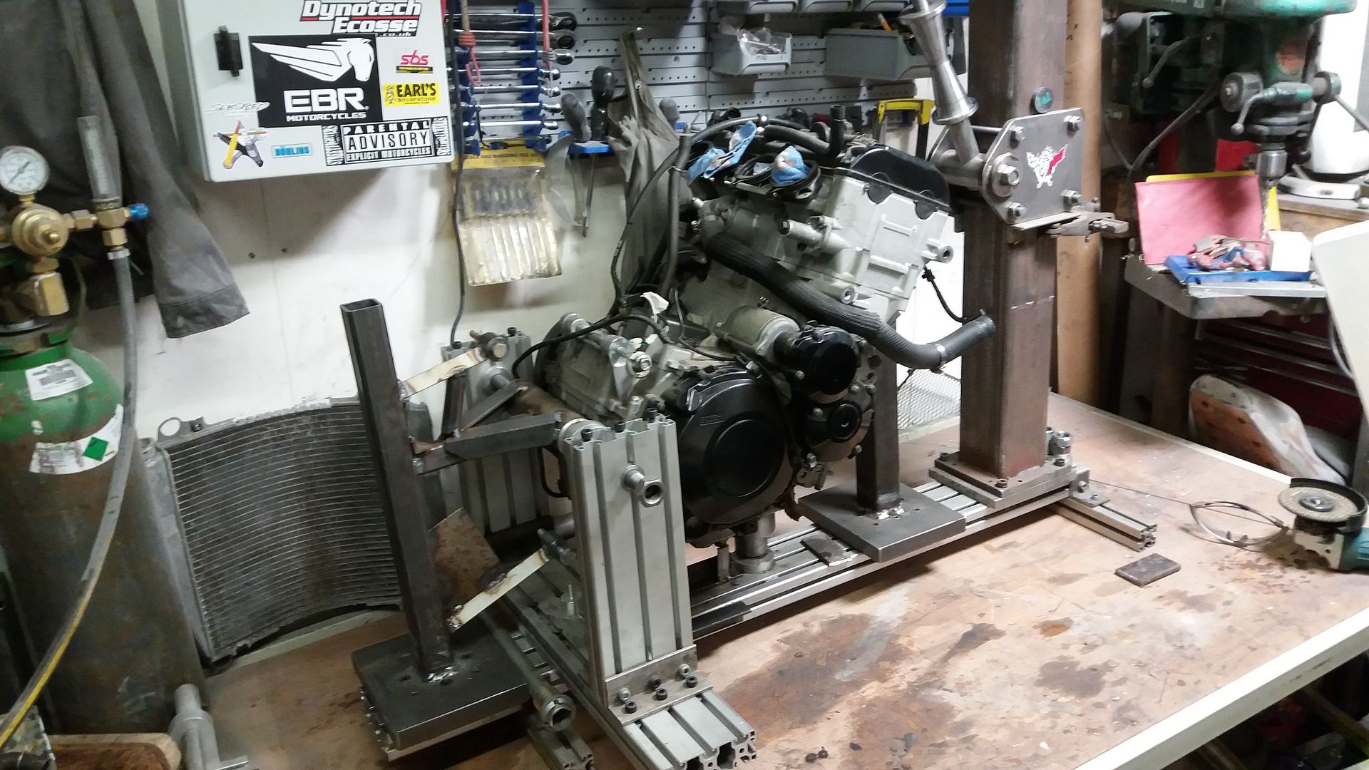

letting the frame and engine be properly supported by the jig
the next fun bit will be to get it sitting at the correct angle

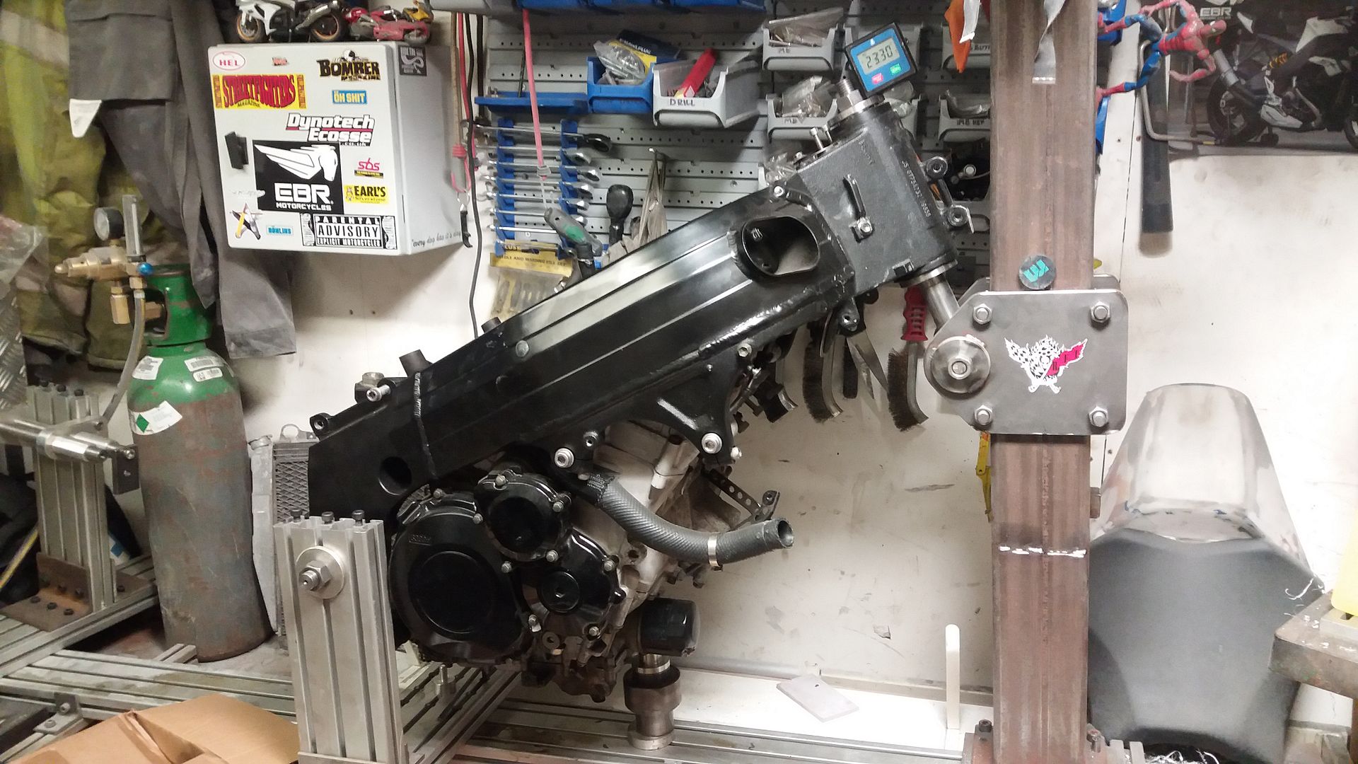

Discussion starter · #30 ·

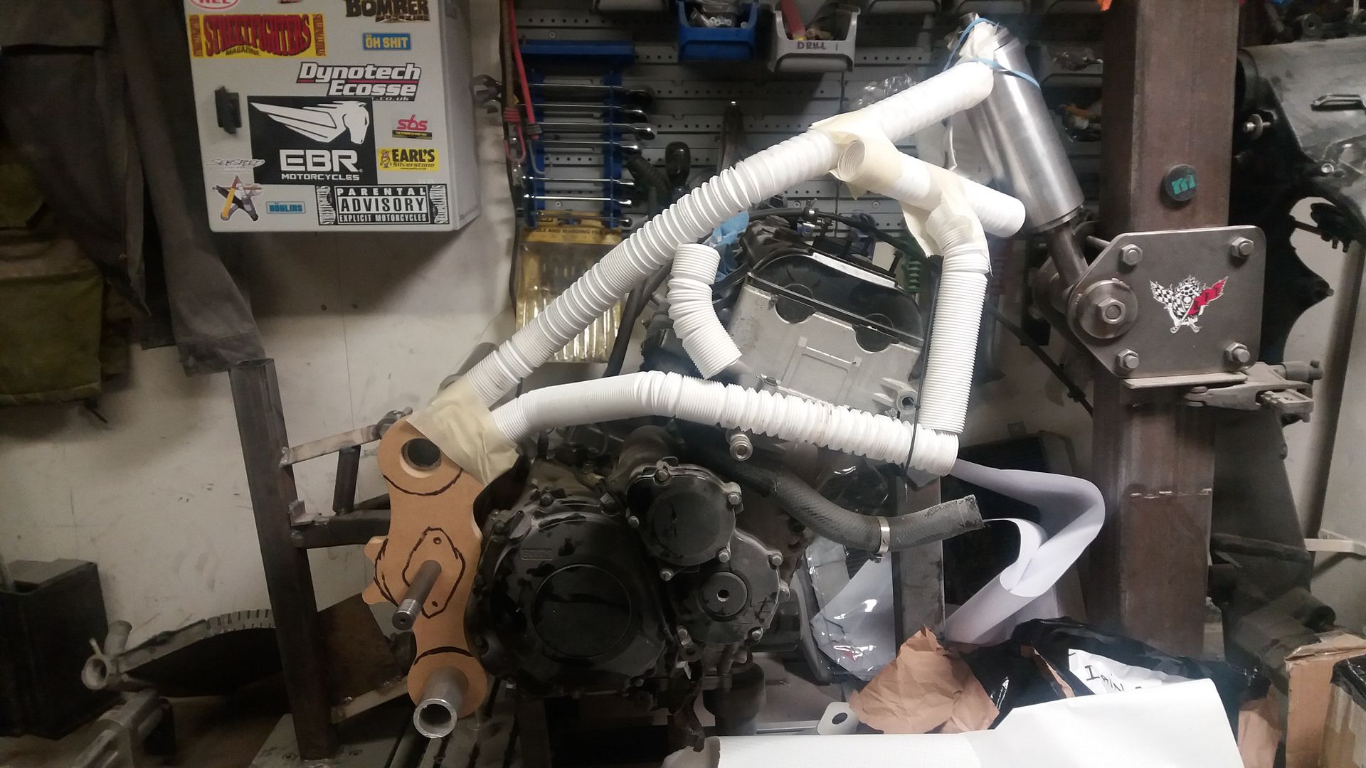

time to get the frame to the proper angle, much easier now I have the swingarm spindle to pivot on
meant to be 23.5, but this'll do, it's more for visual than anything as all the other points will be jigged in relation to it

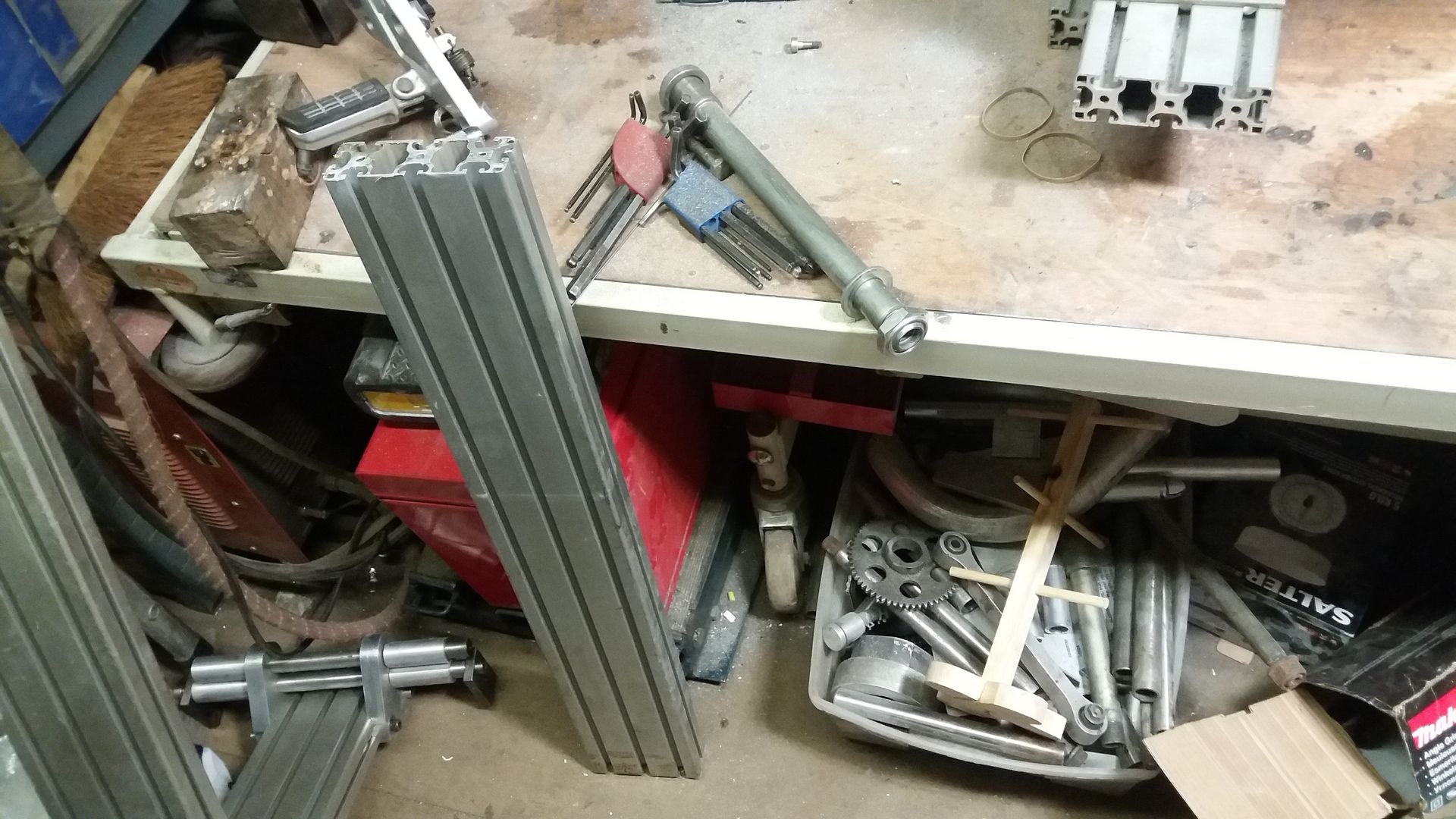

my adjustable support comes in handy again

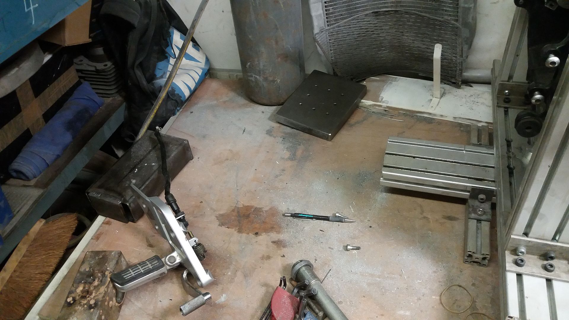

Decided to shorten the base of the jig, made it long enough for all eventualities, but to be honest I need it to be more movable, there's no way I could get to both sides of it to make the frame
that's it about 3ft shorter ( chopped a little off the other end too )

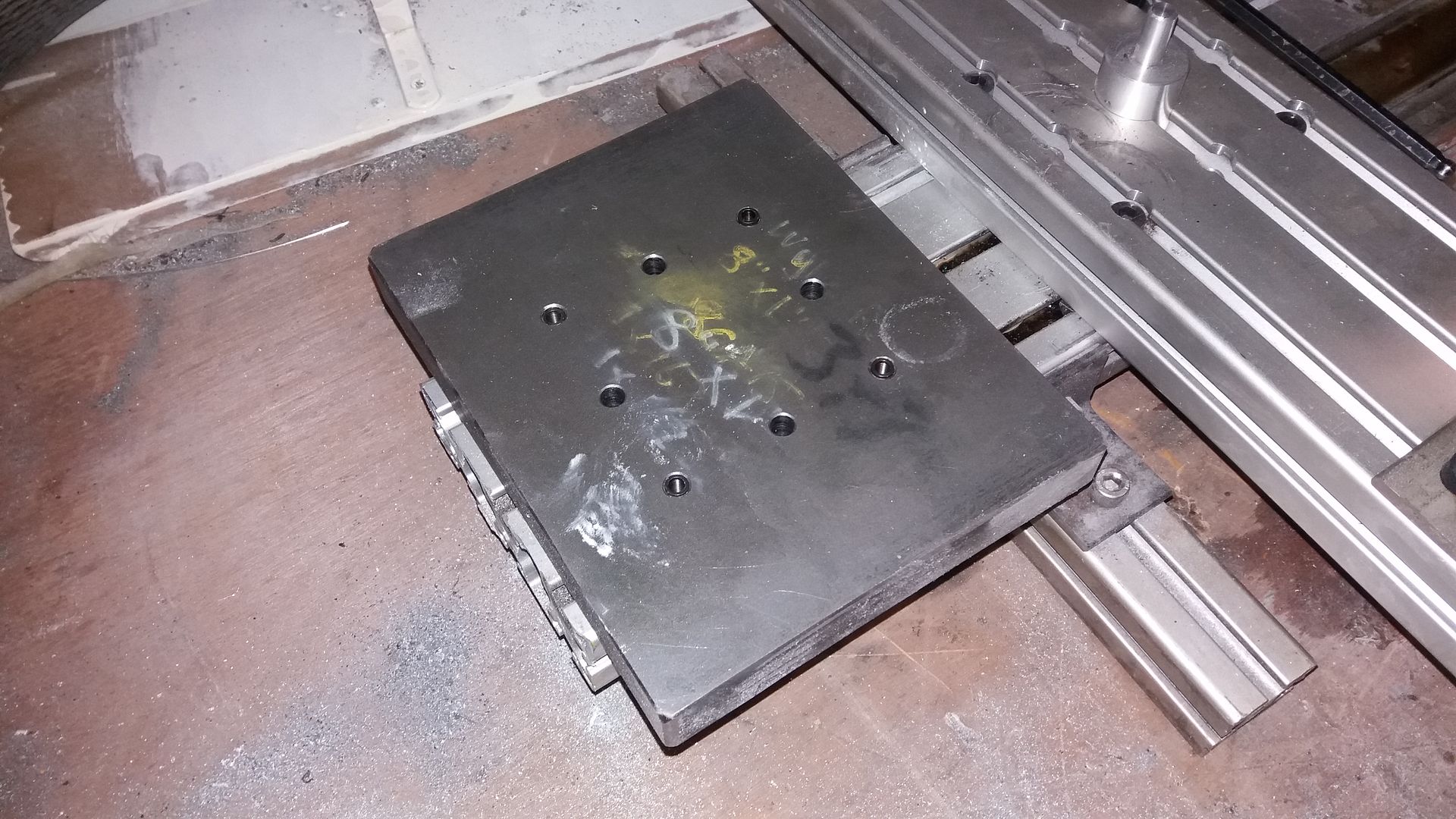

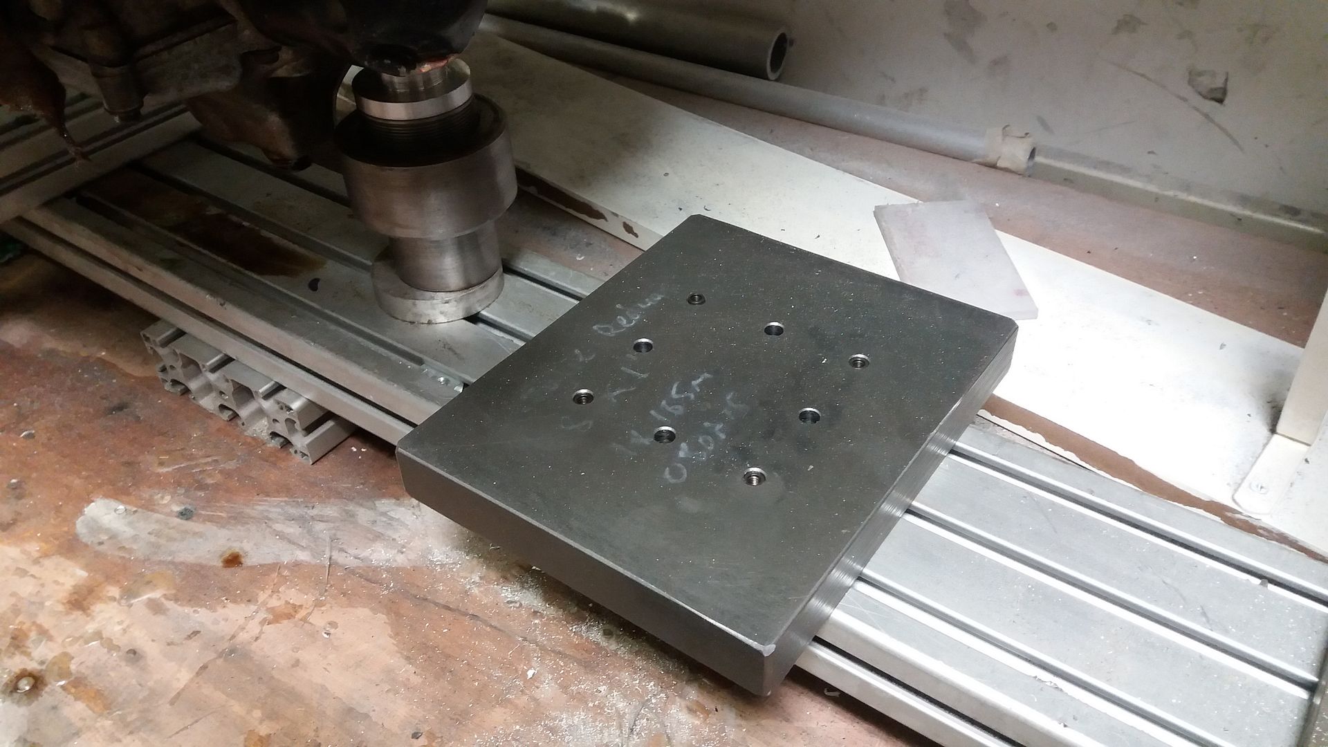

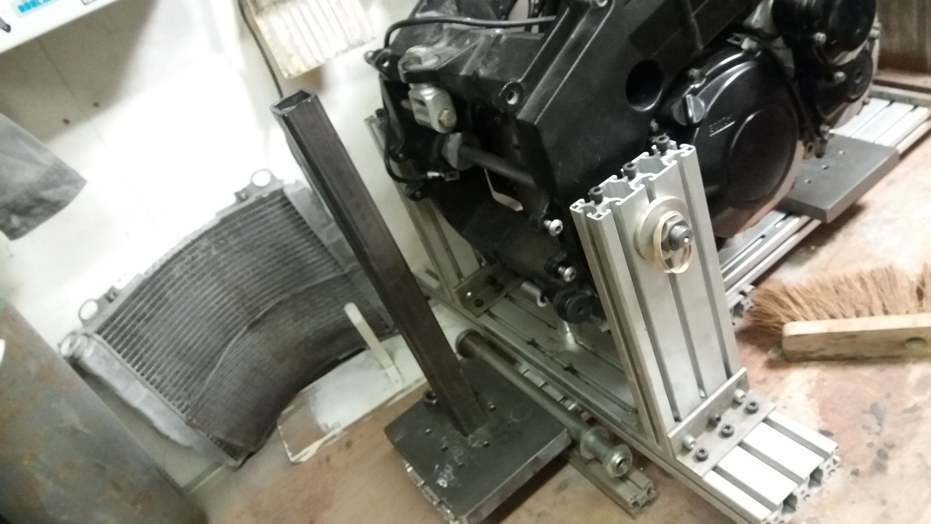

this plate will tie onto the base and have fittings welded to it to secure the engine

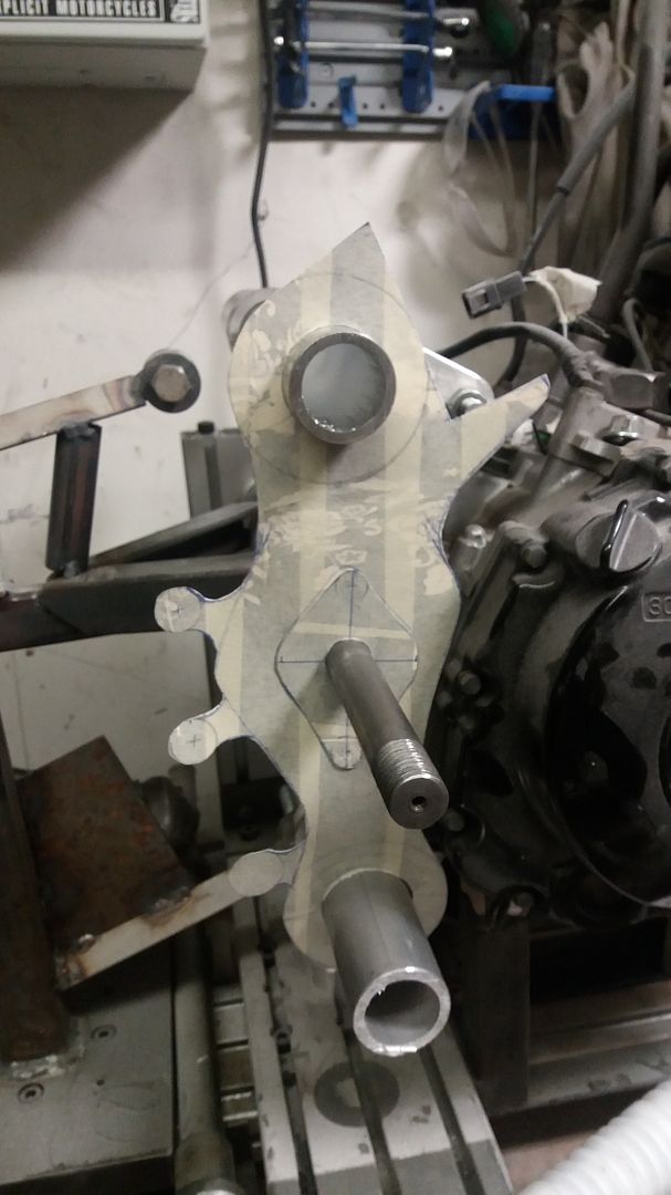

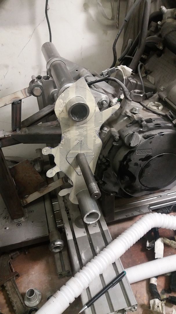

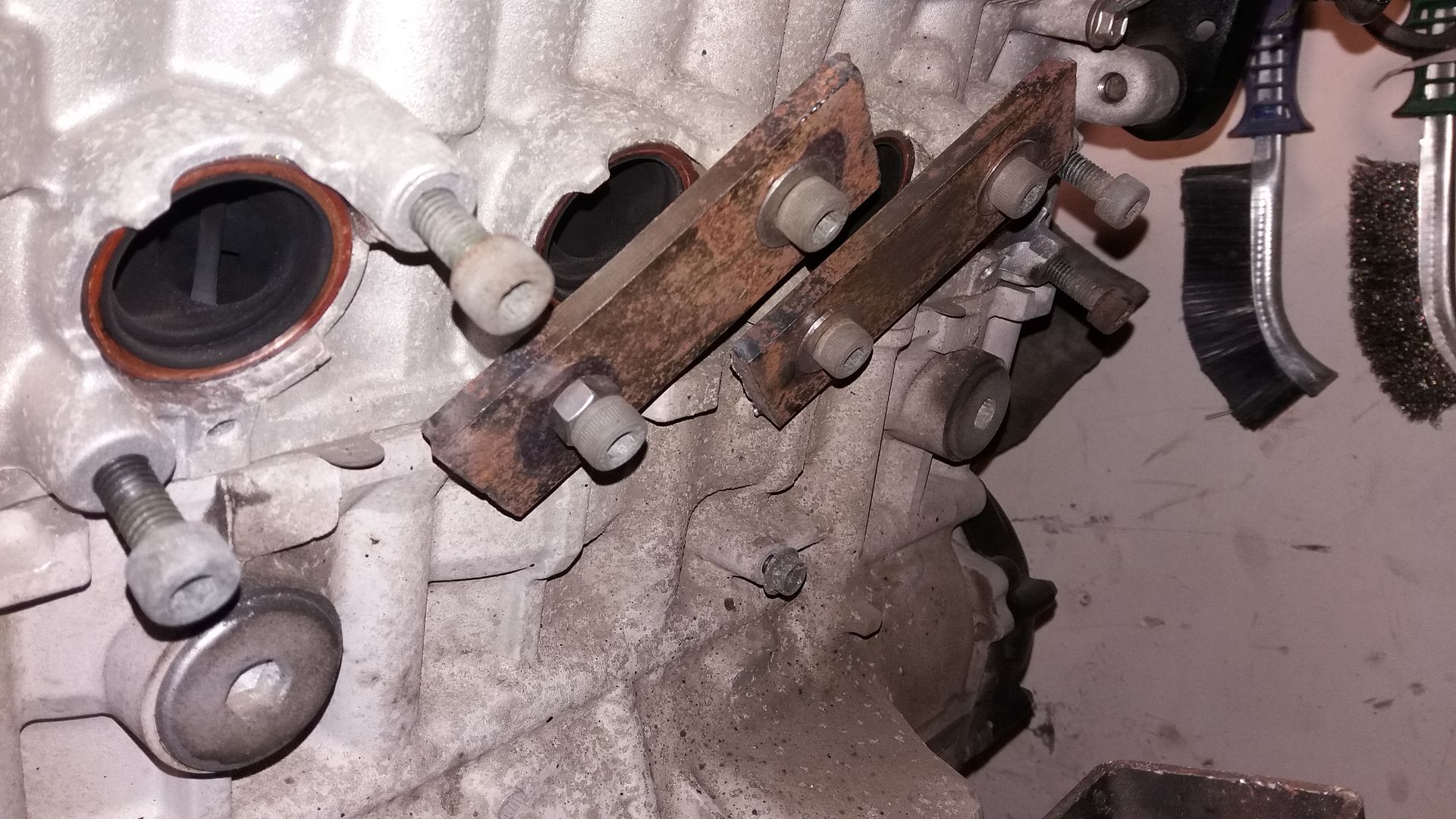

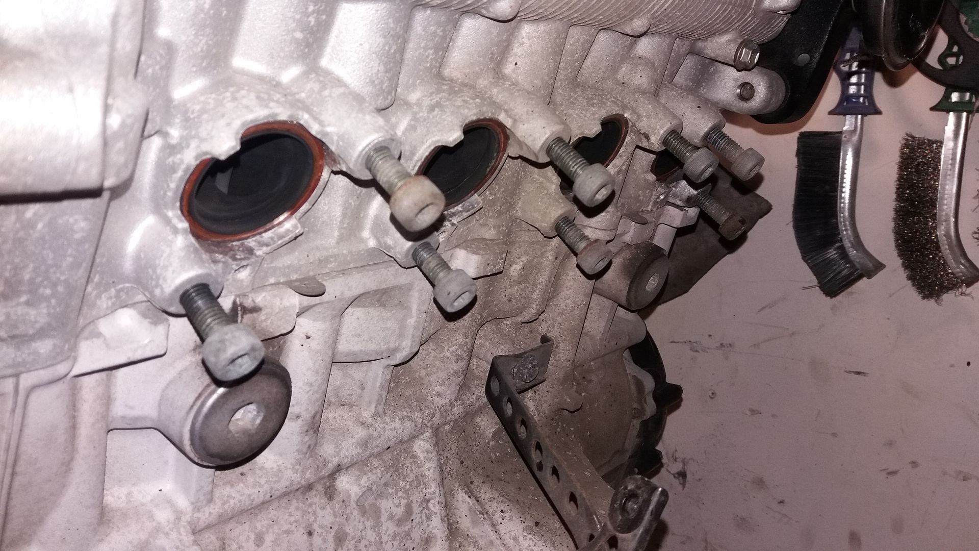

going to make a plate up to bolt onto the exhaust studs
a second plate sits on the other side
it'll have a post like so
that'll connect to these

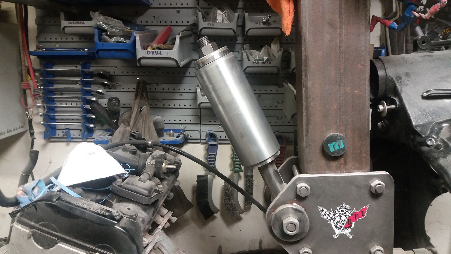

one in the top shock mount
the other in the linkage mount
unfortunately the lower one is a few thou too wide , need to get me to a lathe , resisted the temptation to buff it down, frame will only be as good as the jig

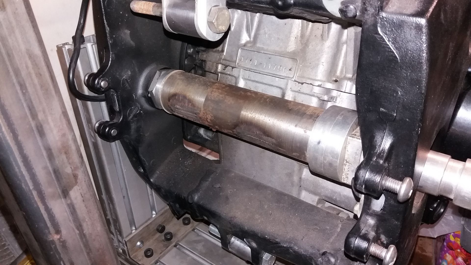

I wasn't happy that the cross piece of the jig was spot on, so I loosened everything off and took the swingarm pivot pin back out. While I was putting it all back together I remembered I had a steel tube with inserts in the ends with 20mm holes, used it while putting new pivot points in the Z650 frame, so that's in the frame now ready for attaching to the jig
It has a mashup of spacers along with it, but I'll make proper ones
the lower insert was trimmed to length
and the front mounting plates started

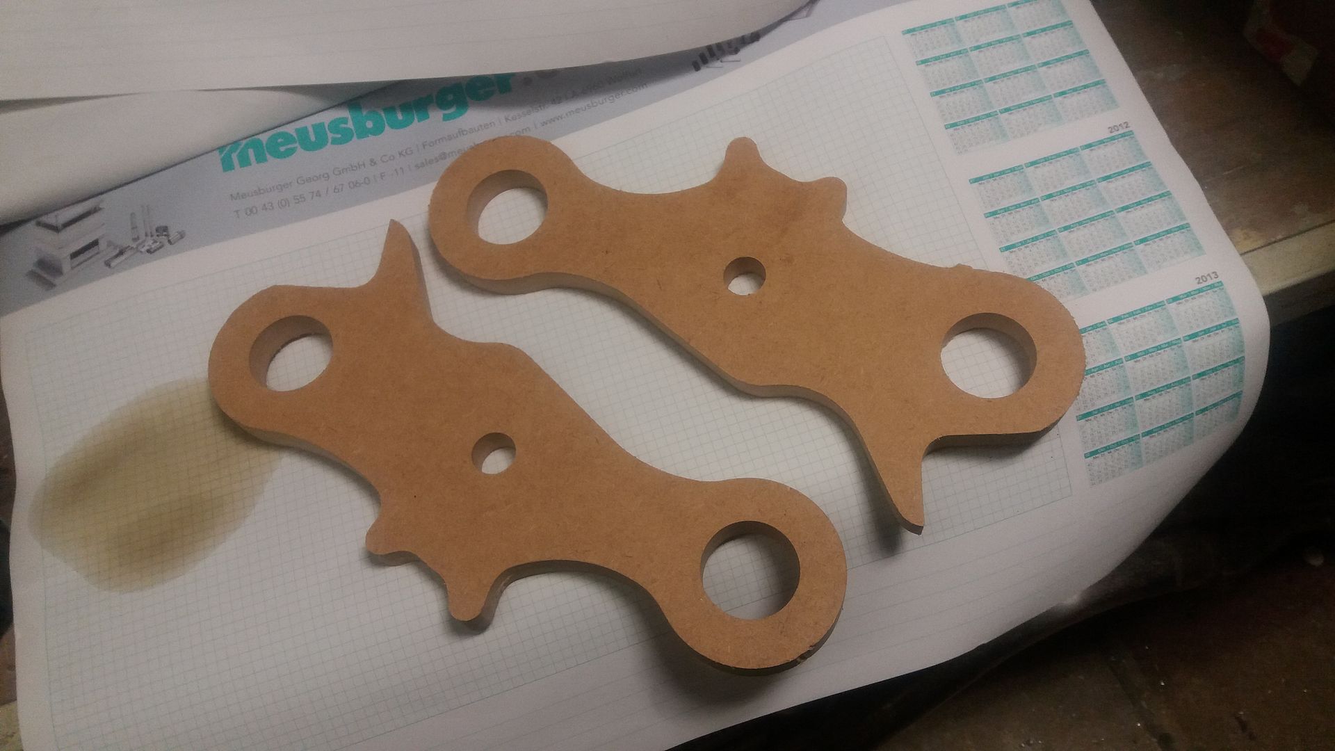

soo I'll change the neck angle a bit , make adjustable offset yokes (letting me set the trail ) , an adjustable swingarm pivot and ride height adjuster for the shock... hopefully that'll be enough to set it up

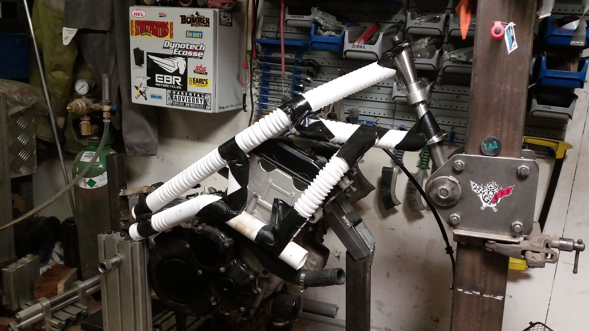

looks like I'm done welding for the next week or so
but I was able to get to this point
I'll need to collect the throttle bodies and airbox, should have done that yesterday when I was at the shop

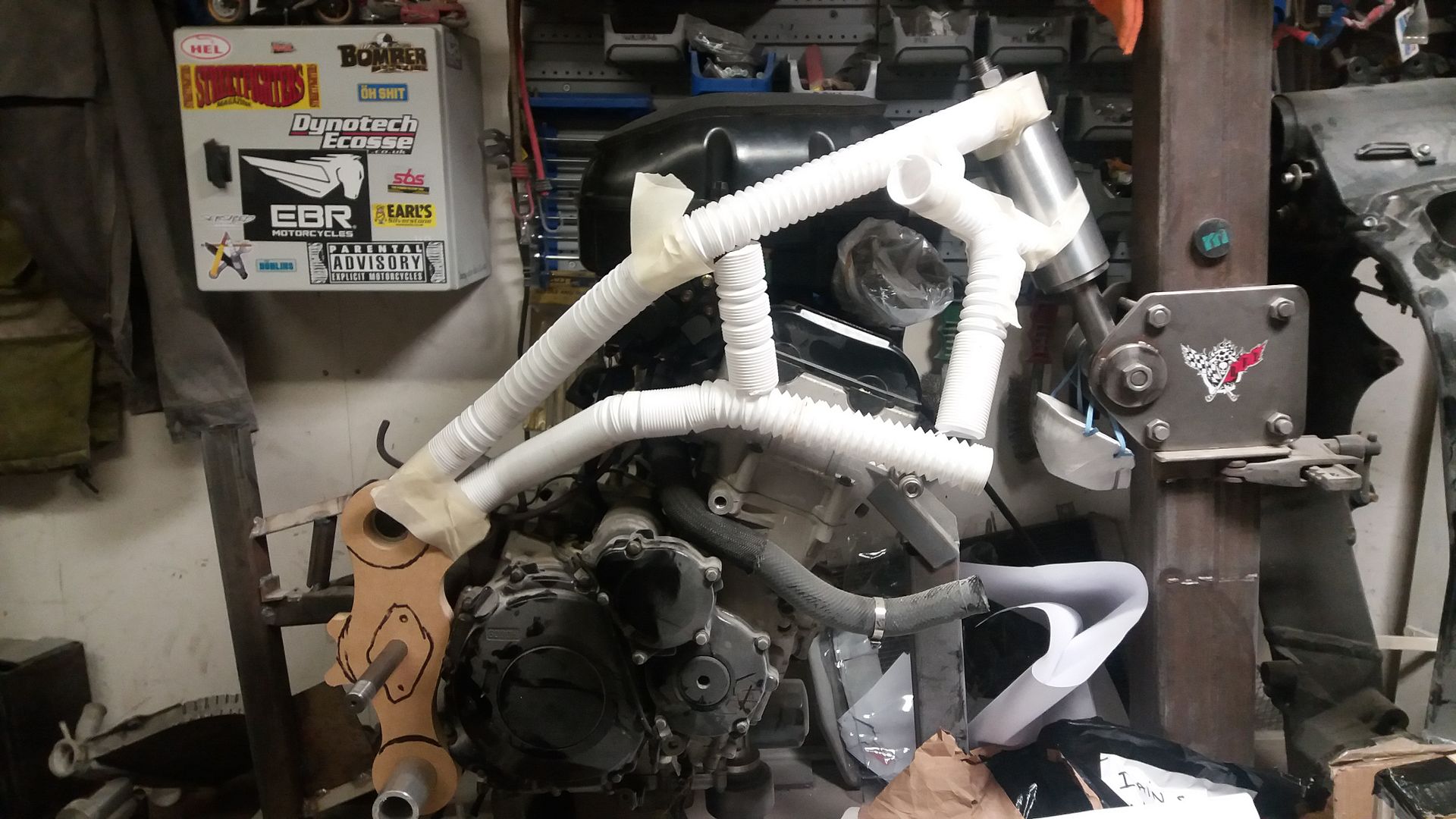

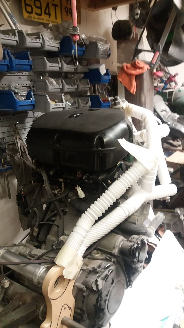

but since I'd got this far I had a mess about with flexi pipe

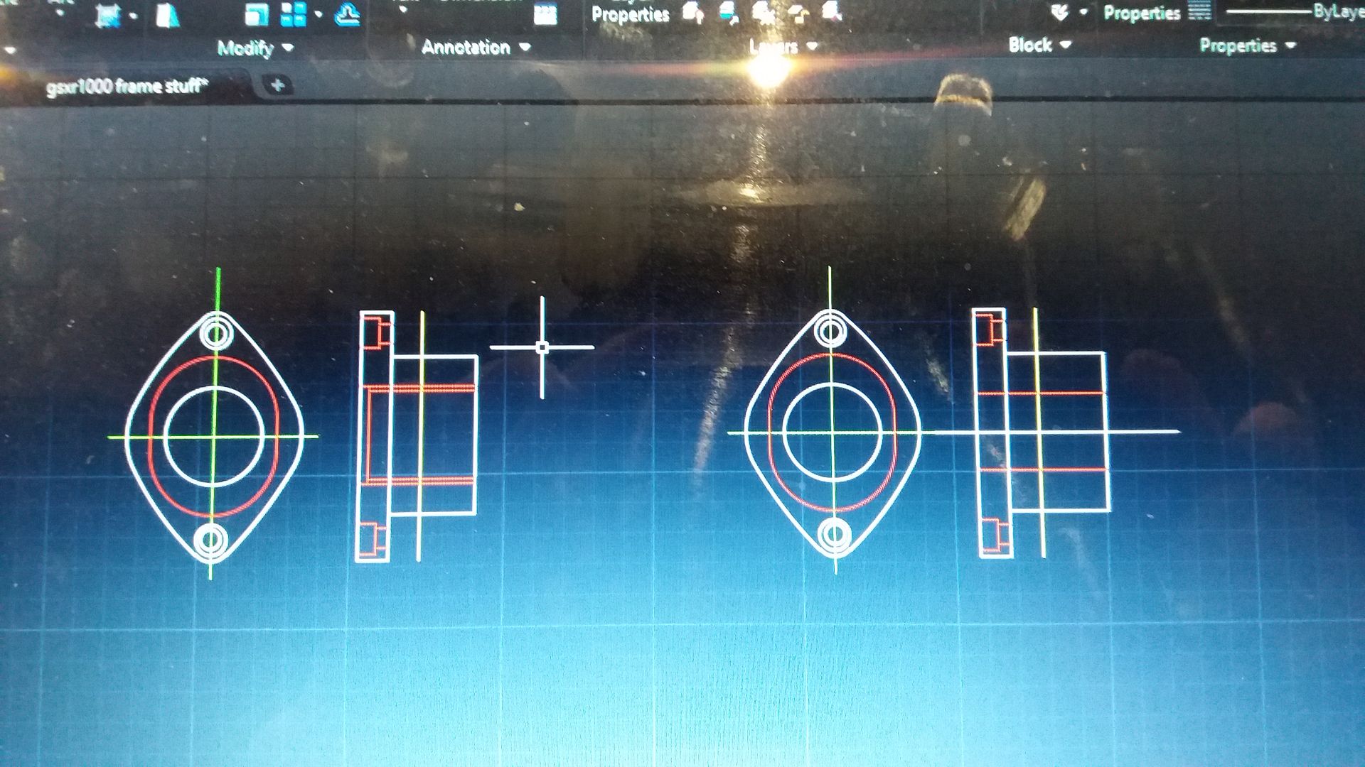

31st Dec.. 23:00hr...what to do ?

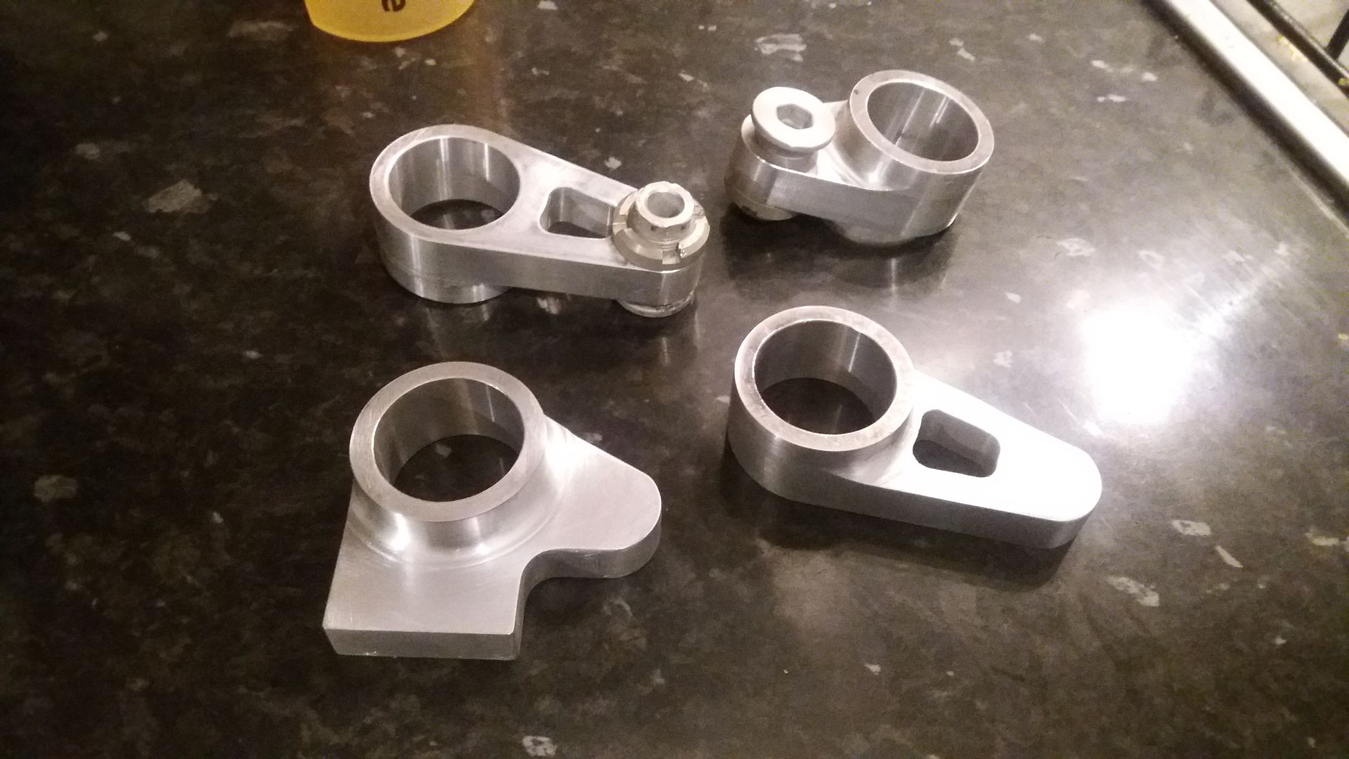

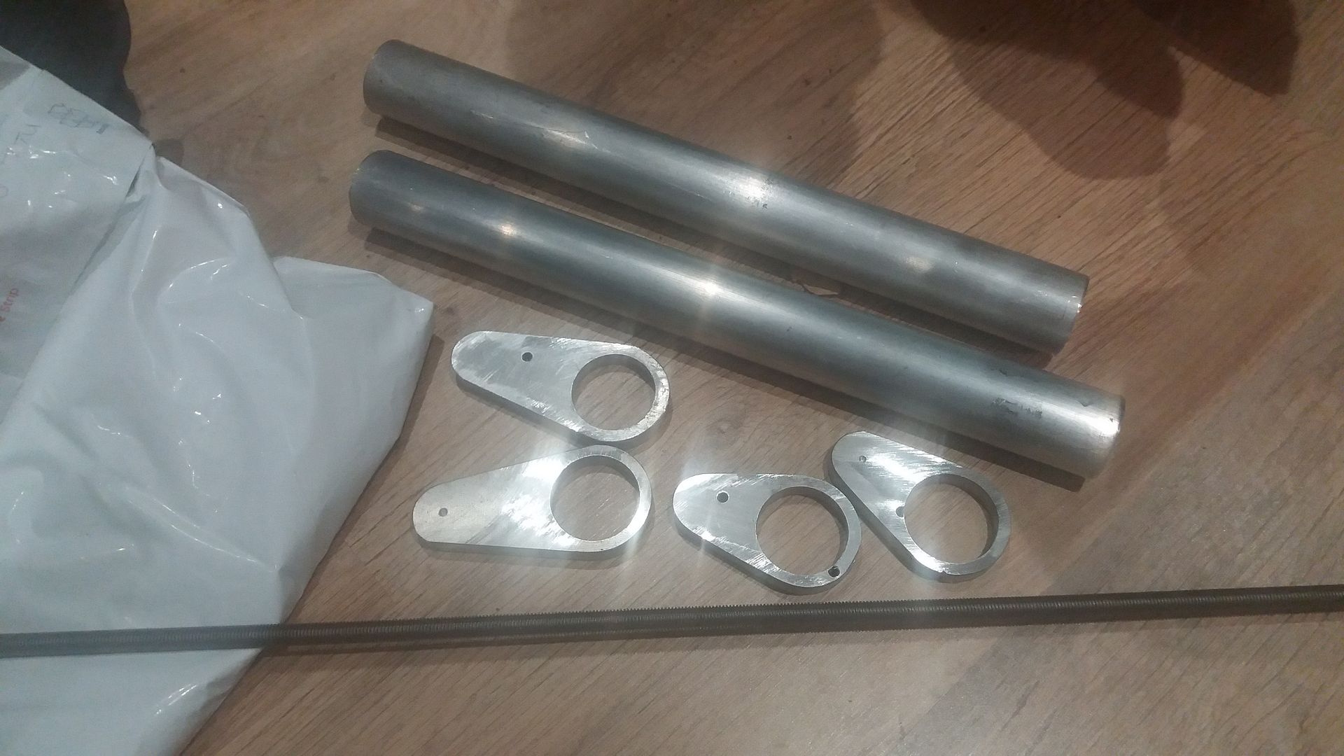

design frame components
that's the inserts for the adjustable swingarm pivot point drawn up , they are of course subject to change, but the basics are there, I can get 5mm up or down with these
